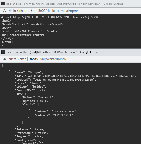

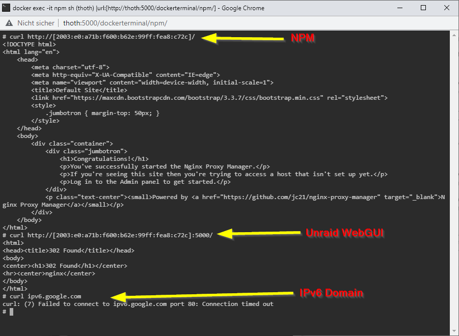

But there is still something wrong as my npm container is able to connect IPv6 addresses, but it seems, it is not able to resolve IPv6 domains:
EDIT: Ok, this is strange. Although I disabled IPv6 for the bridge network, the NPM container is still able to connect through IPv6?!
