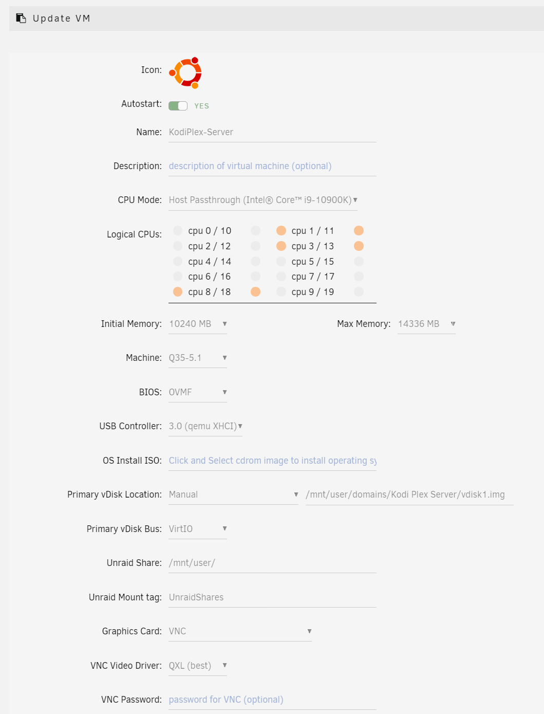

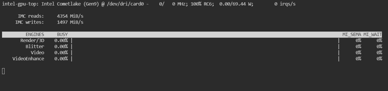

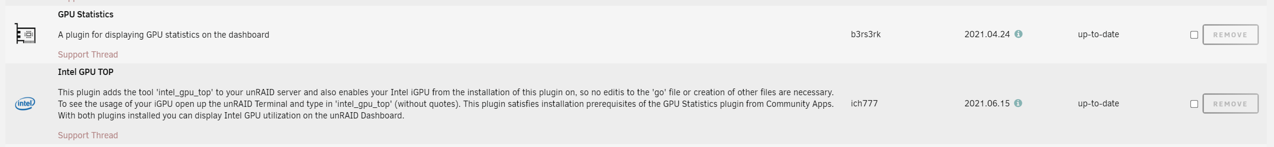

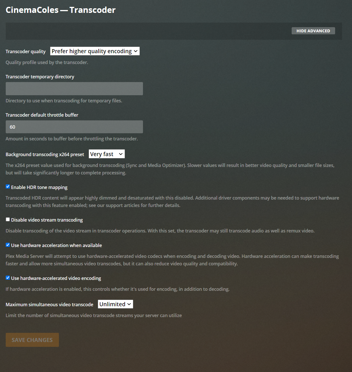

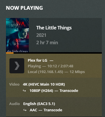

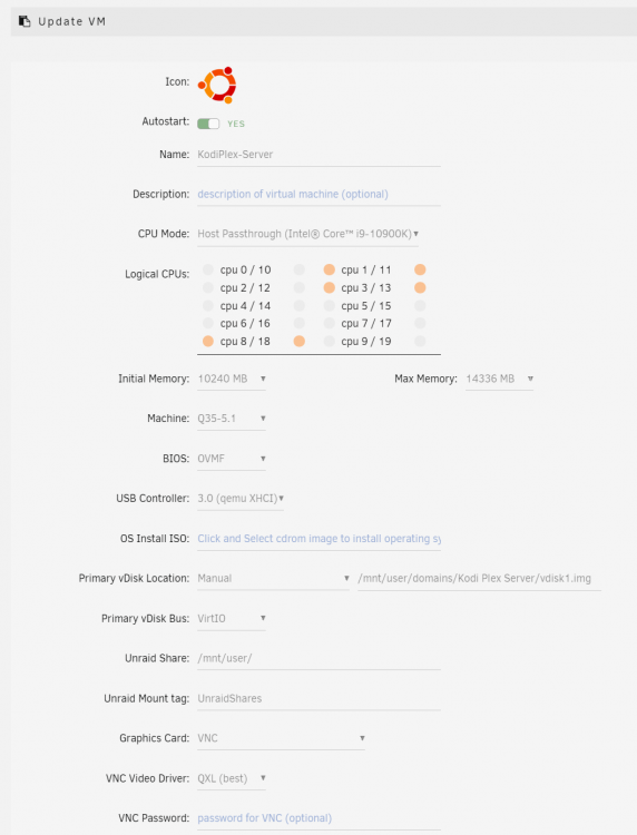

July 5, 20215 yr Sorry guys; believe me - I did look and I'm clearly missing something. CPU is i9 10900K This is a VM setup and I want it to really stay a VM setup as when I buy a eGPU enclosure - I'm going across to a GTC1660S however for now - I'd like to work out whats going on. So Docker is not a solution for me. Any help as always is very appreciated. Ok here's the problem: Should say Transcode (hw) Intel GPU Top shows: The Plex and Kodi combination in UNRAID VM is: Plex settings:
July 6, 20215 yr VNC has no hw acceleration, you need a gpu/igpu that supports it. Even if you are passing through the cpu, you are not passing through the igpu. Edited July 6, 20215 yr by ghost82
July 6, 20215 yr Author 54 minutes ago, ghost82 said: VNC has no hw acceleration, you need a gpu/igpu that supports it. Even if you are passing through the cpu, you are not passing through the igpu. Sorry you've confused me a little... gpu/igpu - I am using a 10900K which has igpu (UHD 630)? Edited July 6, 20215 yr by SmokeyColes

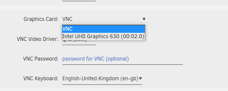

July 6, 20215 yr Hi, what I understood is that you want hardware transcoding inside a vm. To do this you need obviously the hardware inside the vm to be able to transcode. Your cpu has a igpu, which should be able to do so, however when you passthrough your cpu (host passthrough) you are not passing through the igpu. As far as the "graphic card" in the gui of the settings of the vm you selected "VNC", i.e. you connect to the vm through vnc (with the qxl driver); qxl video, which is an emulated card, is not able to perform any hardware transcoding. You need to passthrough to the vm a dedicated pcie gpu (easy), with hardware transcoding capabilities, or the igpu (in some cases a lot less easy ) Edited July 6, 20215 yr by ghost82
July 6, 20215 yr Author Thank you - I see what I've done! Yes instead of VNC, I need to select Intel UHD Graphics 630. However I cant do that as UNRAID uses it at the moment. So I have to accept no hw transcoding. Seems like I need to get that egpu thunderbolt enclosure pretty swift for my GTX1660S Thank you for your help ghost82
