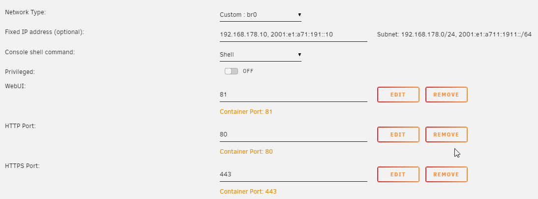

July 8, 20215 yr My internet connection received a new IPv6 prefix. The container did not show the new prefix, so I restarted the docker service. After that the new IPv6 prefix was visible in the containers br0 ip settings, but then I was not able to start the container: docker run -d --name='npm' --net='br0' --ip='192.168.178.8' --ip6='2001:e1:a711:1911::8' -e TZ="Europe/Berlin" -e HOST_OS="Unraid" -e 'TCP_PORT_81'='81' -e 'TCP_PORT_80'='80' -e 'TCP_PORT_443'='443' -e 'DB_MYSQL_HOST'='172.19.0.3' -e 'DB_MYSQL_PORT'='3306' -e 'DB_MYSQL_USER'='npm' -e 'DB_MYSQL_PASSWORD'='npm_100' -e 'DB_MYSQL_NAME'='npm' -v '/mnt/cache/appdata/npm/data':'/data':'rw' -v '/mnt/cache/appdata/npm/letsencrypt':'/etc/letsencrypt':'rw' --memory=1G --no-healthcheck 'jc21/nginx-proxy-manager' a0097056ed2b4ff87a3be79c5f5f23fb40fee4baf05cd35a922d340dd42c9643 docker: Error response from daemon: Address already in use. The command failed. My unraid server runs on 192.168.178.9 so its not related the port, it must be related to the IP. I was able to verify that because starting the container with 192.168.178.10 (and ::10 ipv6 interface id) was no problem. How does Unraid / docker check if an IP is already in use? I tried netstat, but it looks normal to me: netstat -tulnp | grep 443 netstat -tulnp | grep 80 tcp 0 0 0.0.0.0:80 0.0.0.0:* LISTEN 7393/nginx: master tcp6 0 0 :::80 :::* LISTEN 7393/nginx: master udp6 0 0 fe80::b62e:99ff:fea:123 :::* 1905/ntpd udp6 0 0 fe80::b62e:99ff:fea:546 :::* 1826/dhcpcd Finally I restarted the server, which solved the issue, but next time I really like to know how to analyze the problem.
