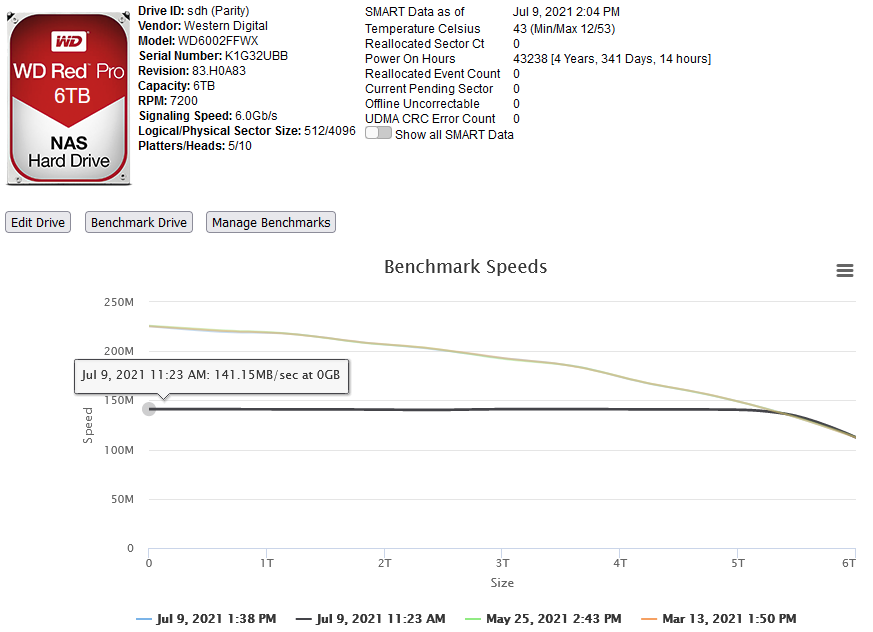

July 9, 20215 yr Just had something odd happen. I needed to look up the <progress> HTML tag for another project and I ran my DiskSpeed app and hit a benchmark on a random drive and did an inspect on the HTML of the progress tag to get it. I could have just googled it but ah, I digress. I noticed that the speed was flat lined at 141MB/sec. I let it finish and it started to go down towards the very end but was flat up until that point. I ran subsequent tests and they all showed the same thing - a max bandwidth of 141MB/sec while all other drives on the same controller (motherboard) behaved normal. I did a power off reboot and now everything is back to normal. I didn't think to save off the syslog so no checking that. Anyone else have had this happen to them?
July 10, 20215 yr Author 6 hours ago, UhClem said: Smells like Sata 1 Interesting. You might be right. I'll be keeping an eye on it and will monitor the syslog.
