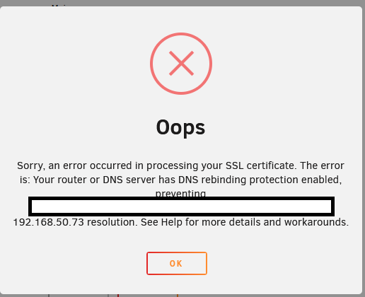

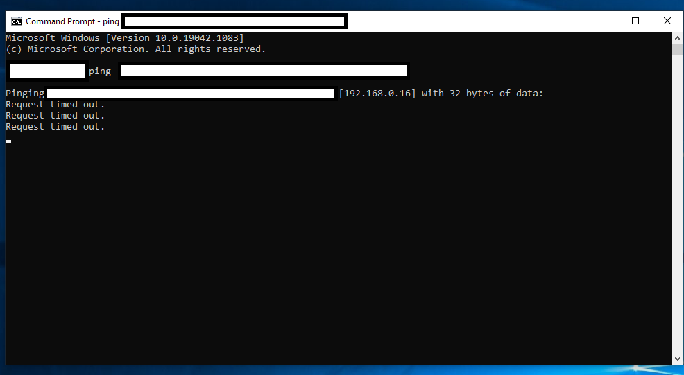

I keep getting the provision error. After pinging the address I noticed the IP does not match the IP from my new router. Is there a way to correct the provision so it goes to the correct IP address?

Also I think DNS rebranding is an option in your router you need to turn off to be able to setup the SSL certs.

192.168.50.73 is what it is currently (as seen on error), 192.168.0.16 is what is was when I first set it up (as seen on the ping location). So when I click provision unraid is sending it to the old IP and not the new one.
Do you have an option on your router to flush the DNS cache? If not then you might need a restart on the router to reset the old DNS settings so it picks up the new static IP. It looks like you are pinging your server name from a windows box which could also have a old DNS cache which you can reset with the command 'ipconfig /flushdns' and reset with 'ipconfig /registerdns' this should clear out any old DNS settings on the windows box and pull fresh DNS from the DNS server (router).

We have discovered an issue with our DDNS when your server changes IPs (or possibly just when it changes subnets.) For now you'll need to disable SSL or revert to your previous IP.
It works, thanks.
