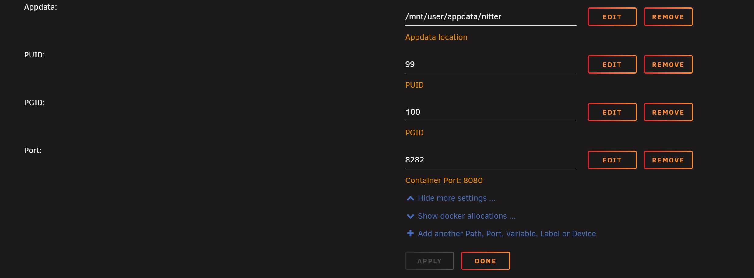

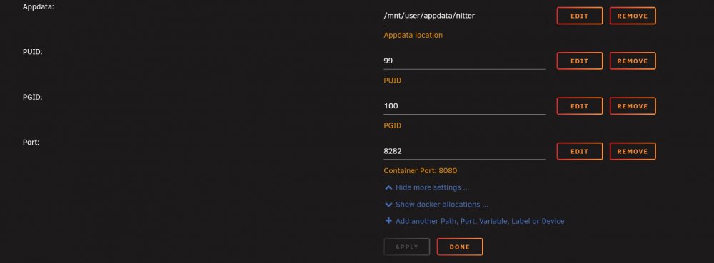

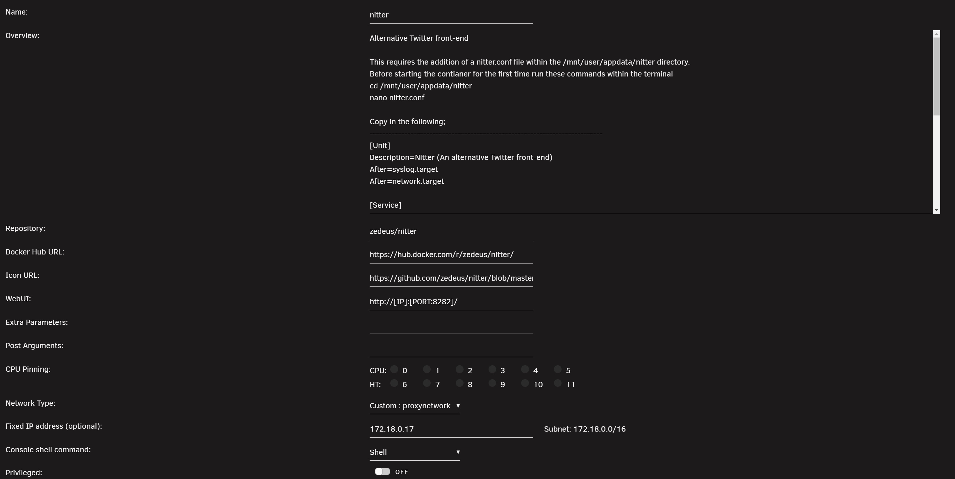

July 21, 20215 yr Author So i tried again and seem to have this working. I have attached some pictures to anyone who is playing along at home. I am unsure of its stability at this time. However if there is interest I may learn how to publish it to CA for others to enjoy. the appdata variable is set to the container /config I was able to use the reverse proxy to provide ssl which also works nice. There is a config file which i describe in the descrption that I have written in the box that gets cut off so ill post the contents of that into here. [Unit] Description=Nitter (An alternative Twitter front-end) After=syslog.target After=network.target [Service] Type=simple # set user and group User=nitter Group=nitter # configure location WorkingDirectory=/home/nitter/nitter ExecStart=/home/nitter/nitter/nitter Restart=always RestartSec=15 [Install] WantedBy=multi-user.target you could change the port 8282 to whatever may suit your host ports
