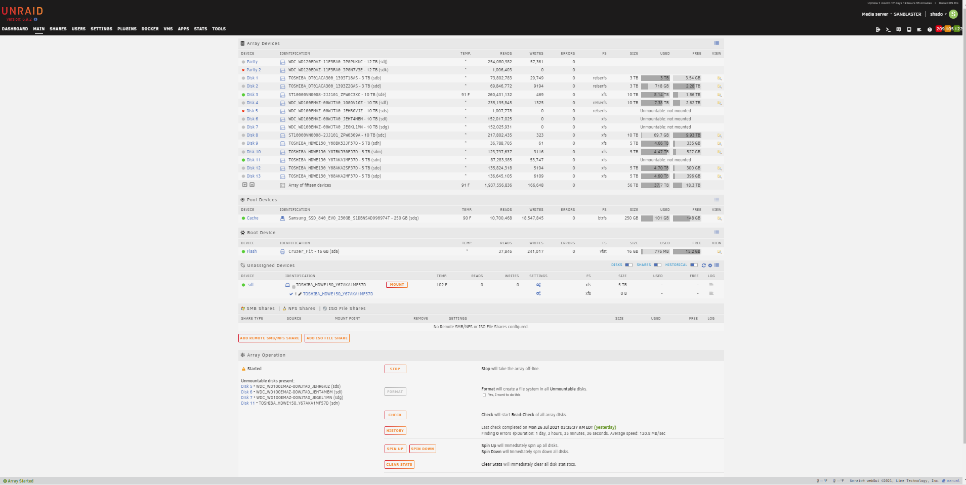

Currently, four disks in the array report the error message “Unmountable:not mounted”.  I tried to repair the disks via the GUI in maintenance mode using reiserfs and xfs_repair but did not succeed.
Also, Disk 5 and Parity 2 report as disabled after last reboot.
I don’t know what is wrong?  I have run the system over 40 days and have seen no other disk fallouts.  Any ideas?

I followed the guidelines of the wiki.  I have ran the checks again and posted the results for disks 5, 6, 7 and 11.
