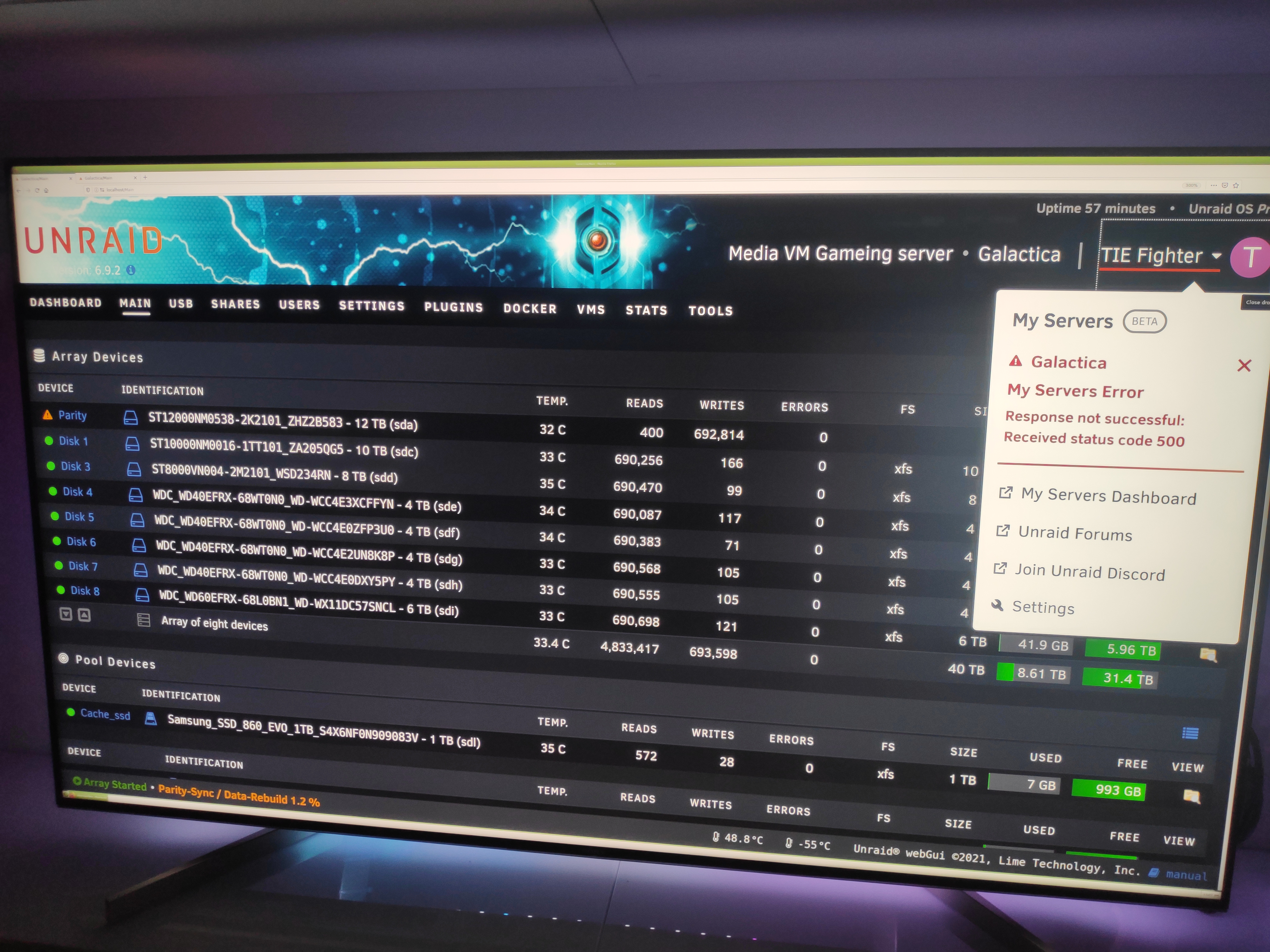

August 3, 20215 yr Hello all. i just flashed my unraid backup from an sandisk ultrafit 32gb into a samsung fit plus 32gb drive. i restored me license key into the new drive but when i am running unraid in GUI mode i got a notification on the "my servers plugin" that says My Servers Error Response not successful: Recieved status code 500. this is visible while loged in as localhost. if i create a new tab and access the server with the ip adress it is not appearing. remote access login gives an exclamation mark at the my servers notication. settings - management access everything is normal pls some assistance would be very much appreciated. diagnostics attached galactica-diagnostics-20210803-0318.zip
August 7, 20215 yr Open a web terminal and type: unraid-api restart give it a little time and the error message in the dropdown should go away. For more info on My Servers see: https://wiki.unraid.net/My_Servers#Navigating_the_User_Profile_Component
August 9, 20215 yr Author Already tried the command "unraid-api restart" without any changes. Left the server on the complete day, the error message are still there. I tried to create a completely new unraid install using the new flash drive and backup pro key, as soon as the unraid "my servers" plugin is installed and configured the error message appears. All this in gui mode.

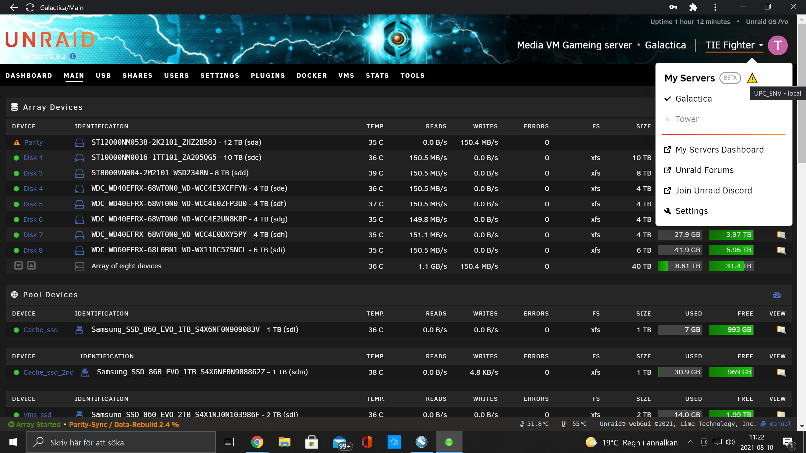

August 10, 20215 yr Thanks for reporting this issue with the UPC on localhost, we'll get that fixed On 8/2/2021 at 6:46 PM, TIE Fighter said: remote access login gives an exclamation mark at the my servers notication. Would you mind showing me a screenshot of this issue? Thanks!

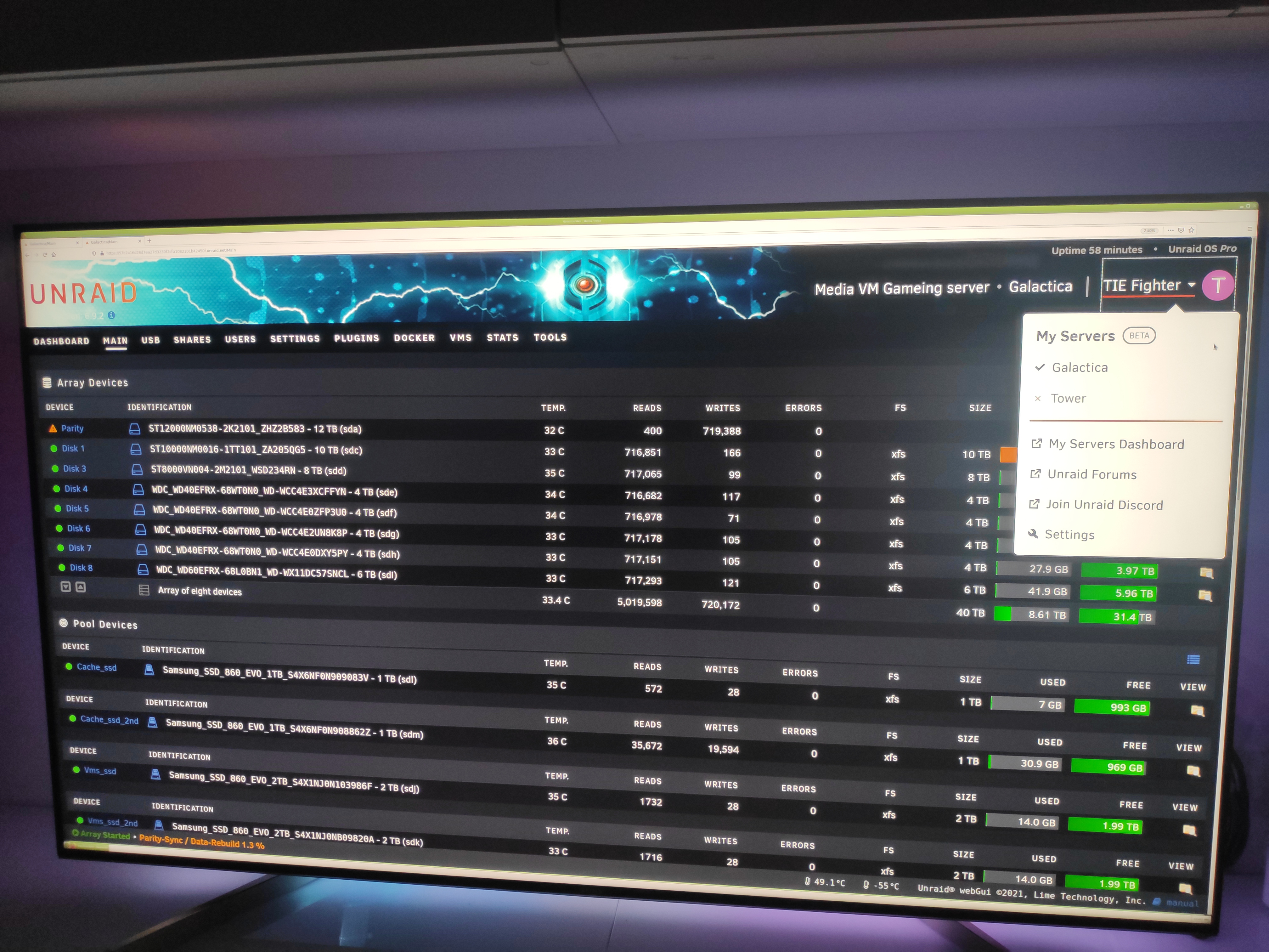

August 10, 20215 yr Author 8 hours ago, ljm42 said: Thanks for reporting this issue with the UPC on localhost, we'll get that fixed Would you mind showing me a screenshot of this issue? Thanks! of course, please see below attached. Photo #1 GUI logged in Photo #2 GUI logged in by server ip address in new tab. Screenshot #3 Win10 VM logged in by server ip address in Google chrome brgds Edited August 10, 20215 yr by TIE Fighter
August 10, 20215 yr Thanks, that was super helpful. #1. We'll get this fixed for localhost #2. All good #3. Safe to ignore, we are going to suppress that icon.
