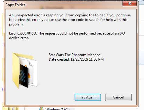

Copy to operation to Disk 1 failed again today- the I/O error.
attached please find upper section of my latest syslog (errors) as well as prtScreen of Windows error message. Full 03-19 syslog is 2,600+ KB. Can zip and upload if needed for troubleshooting.

In spite of two New  preclear runs without errors on Disk1, and successfully adding the Disk back to the Array w/out errors, and all Green, Disk1 I/O errors are back. I've hit a wall. Help?!!
Attempted a file transfer from Windows to  Disk1 and got the same I/O errors as before the new preclears and reassignment of Disk one to a new port (now directly to MB port, w new Sata cables). After this failed copy to Disk1 I tried transfers to Disks 2, 3 and 4. These were successful.
