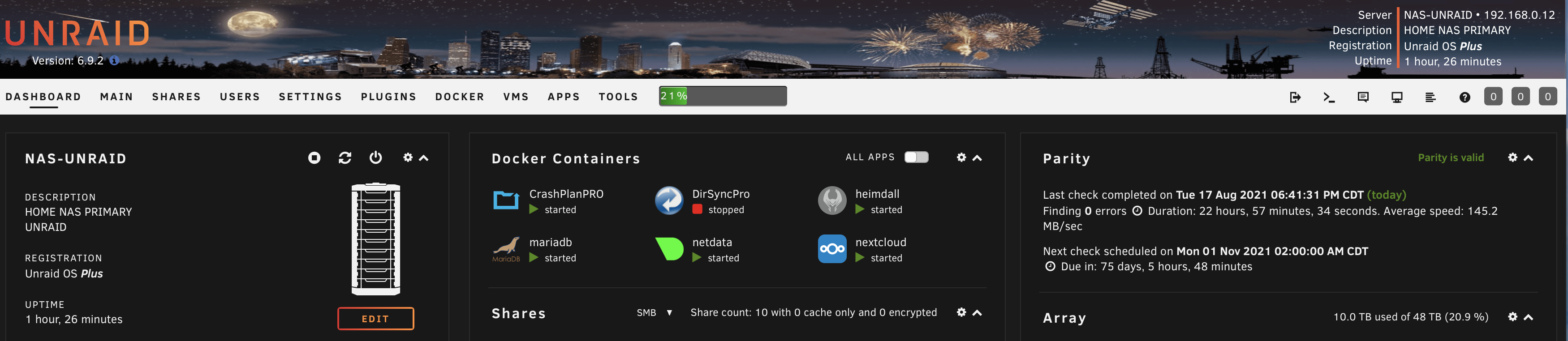

August 18, 20215 yr I recently replaced a failed data drive and swapped with a new one and already rebuilt. Quick question. I was due for a scheduled parity check next week. Do I still need to do a parity check after the drive rebuilt? My dashboard shows as parity check completed. Was the parity check part of the drive rebuild process? Is this an accurate assumption? Or I need to start a parity check manually? Edited August 18, 20215 yr by johnwhicker
