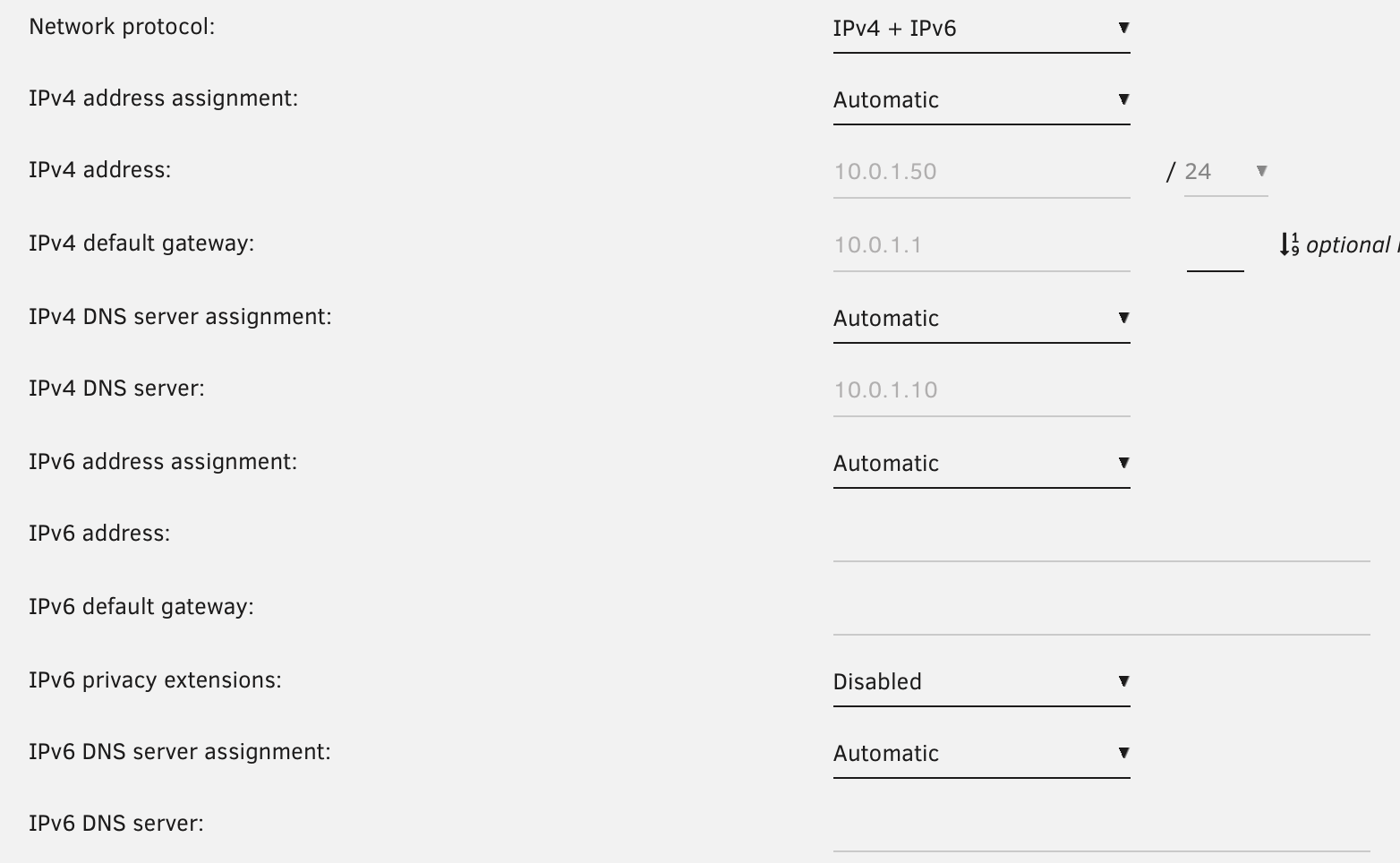

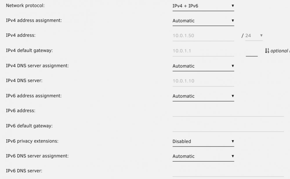

I switched unRAID from IPv4 to IPv4 + IPv6 and rebooted:

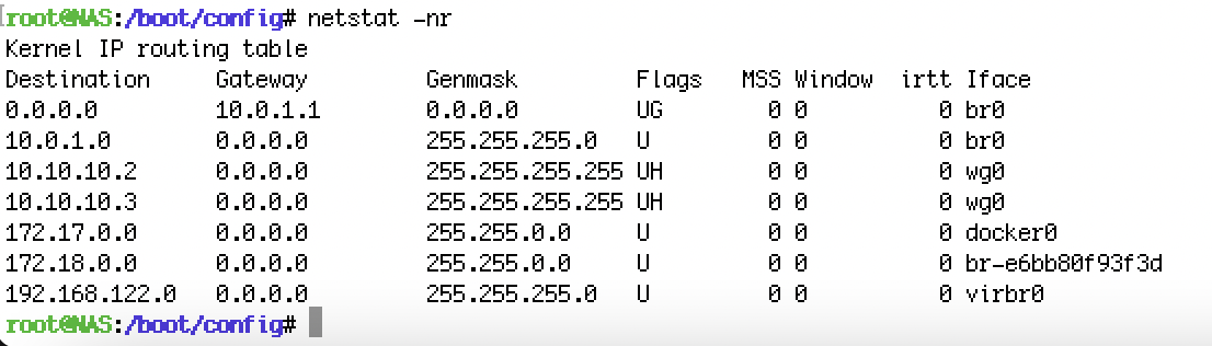

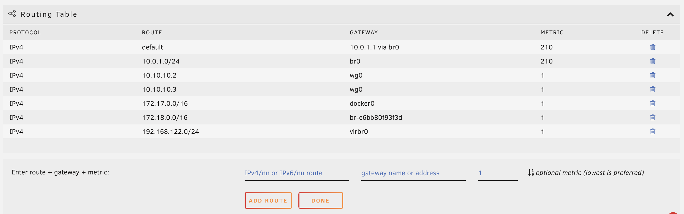

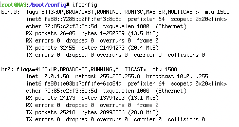

It's recognized (I can ssh) but no IPv6 entries in the routing table:
1516800910_ScreenShot2021-08-23at9_38_32AM.thumb.png.e5a1fe19655496eea890581a11006207.png
1872035154_ScreenShot2021-08-23at9_42_04AM.thumb.png.289a91c6af7259de7a3deeefdd845e55.png
I could have sworn I used to have some. It's possible I deleted them a while ago and forgot.

Your router is not handing out ipv6 addresses. You need to configure your router to do this.
Unraid interfaces have only a link local address, which is not routable, and hence no routing entries.
Right, it never has. So those routes I saw initially, maybe with 6.9.1, shouldn't have been there.
