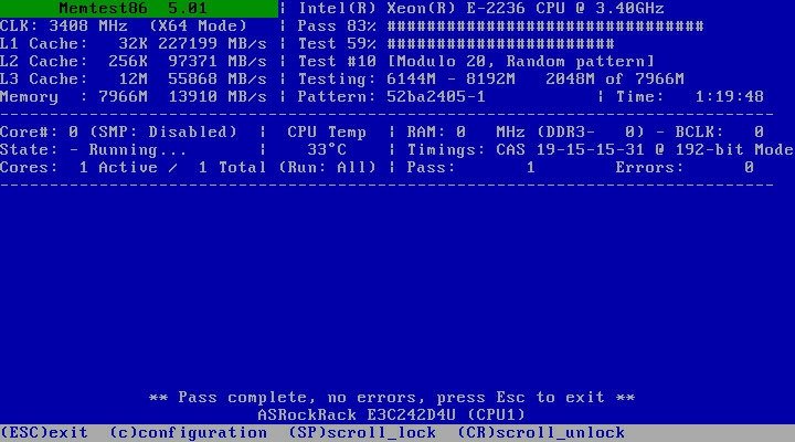

Hi trurl,
Memtest has been  running for almost one hour 20 mins no issues screen capture attached

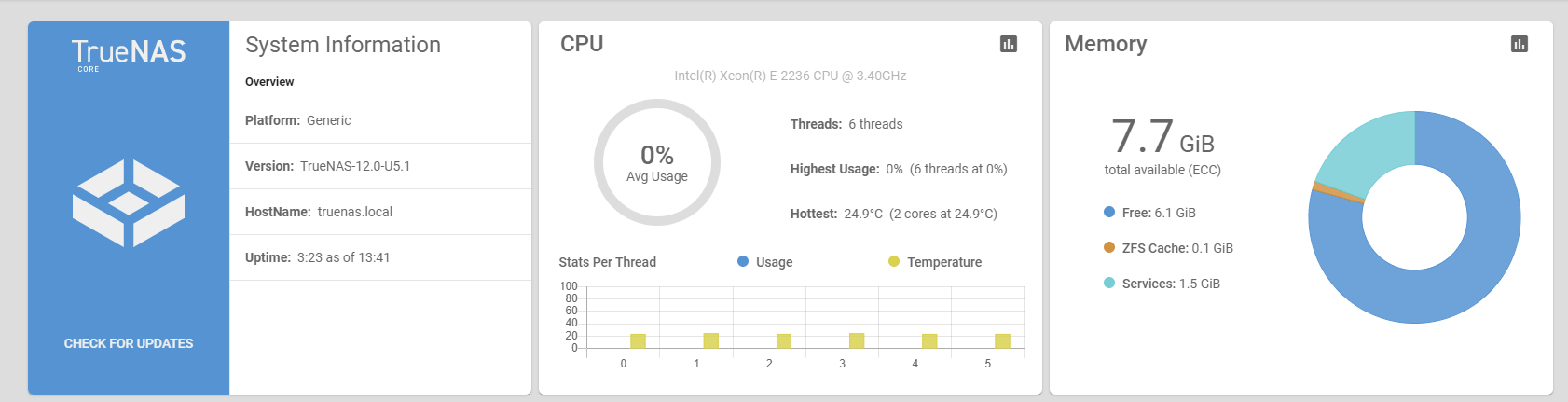

Temporarily installed Truenas and Ubuntu server both run OK only unraid has the issue - of shutting down so I assume it is a driver issue ?

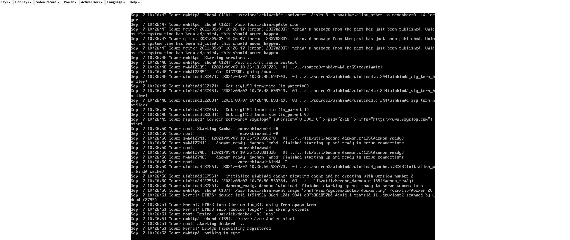

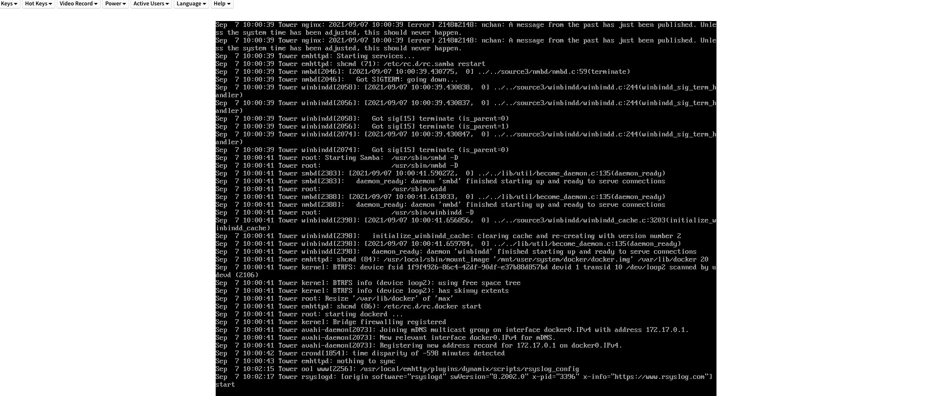

hi Jon
Syslog tail attached - the only thing I can see is there is a time difference 10 hours which is the difference between UTC and Australian EST

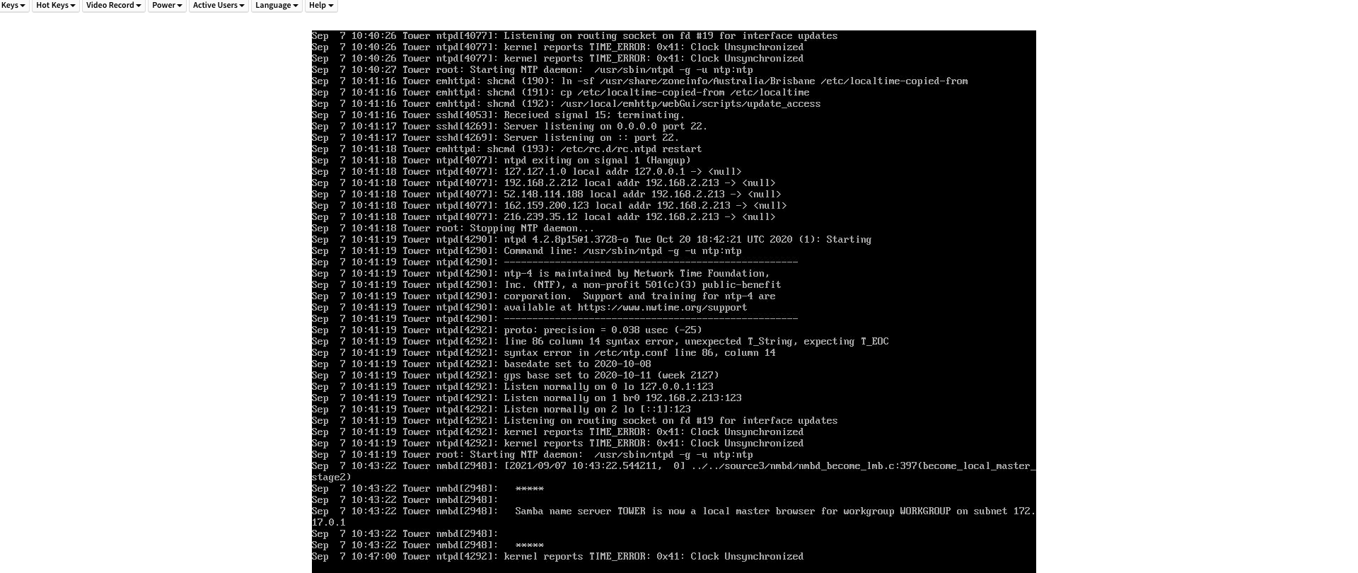

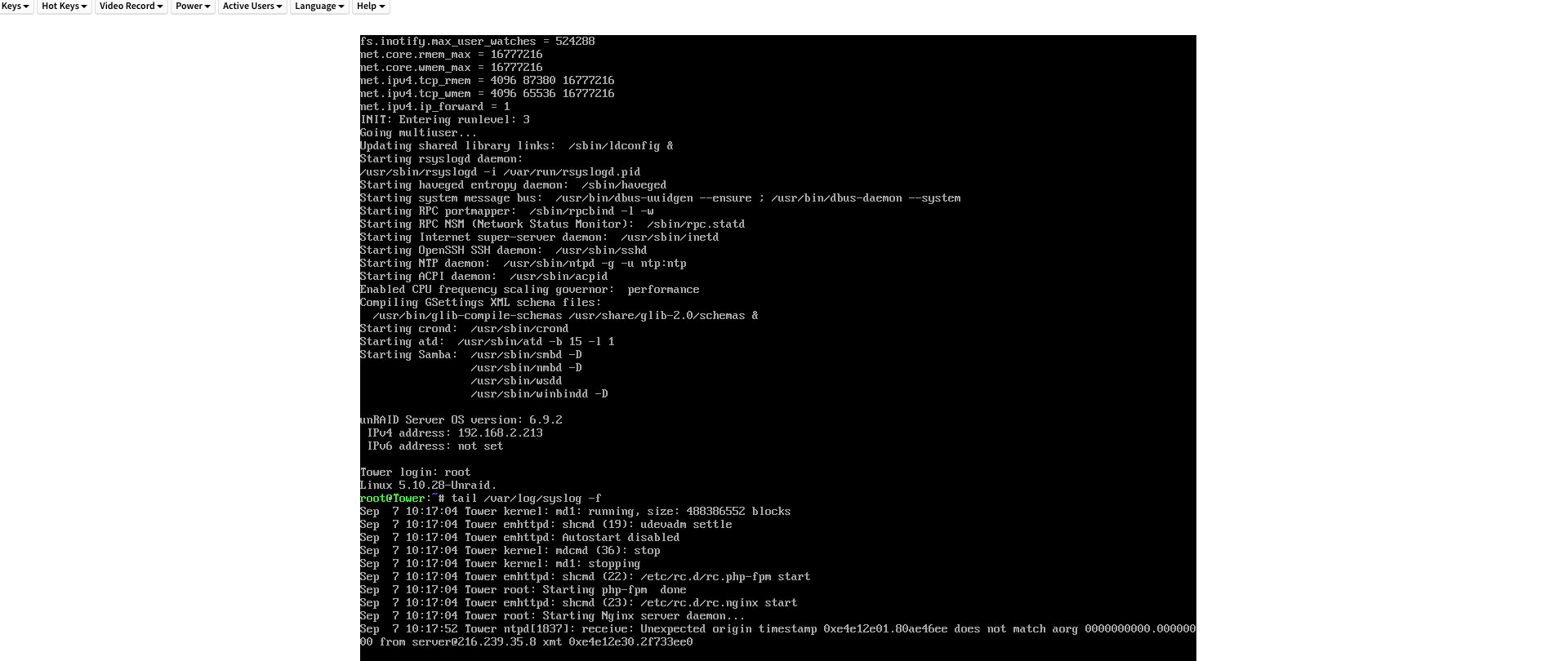

tried setting bios time to UTC and then get this error
something weird with the time going on tried changing the NTP servers
