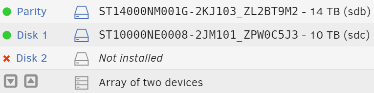

  • Initially I shrunk an array of 2 disks to one disk. That disk was taken out last week and currently in use in a whole different project. I had moved all my data to Disk 1 using krusader, prior to removing Disk 2.

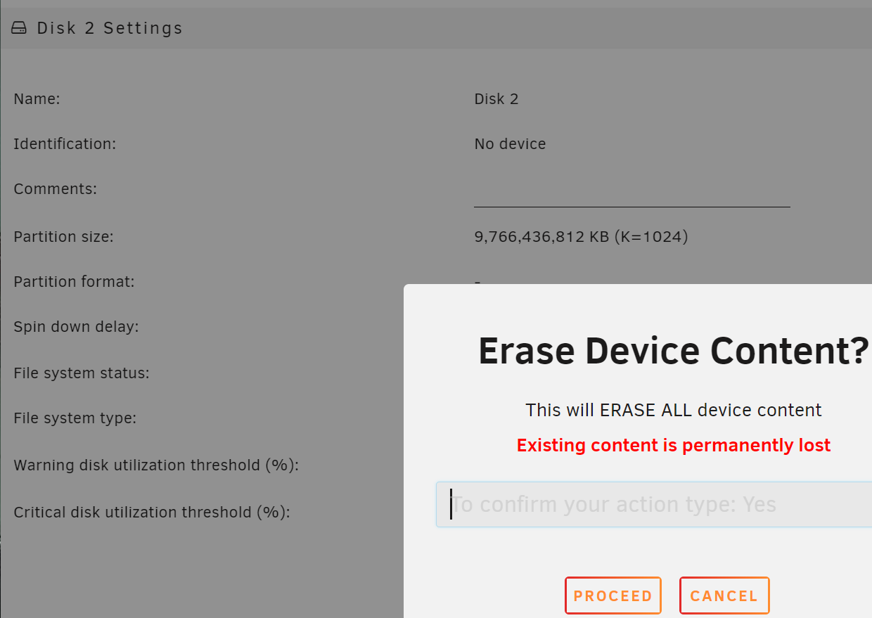

  • After that I did not know how to get rid of Disk 2 from Unraid config. I tried the following while array was in maintenance mode. image.thumb.png.8131374607cdac4225ec79ac8a4324cf.png
    • This did not change anything on GUI ( I still have that Disk 2 with a red X mark under array devices.

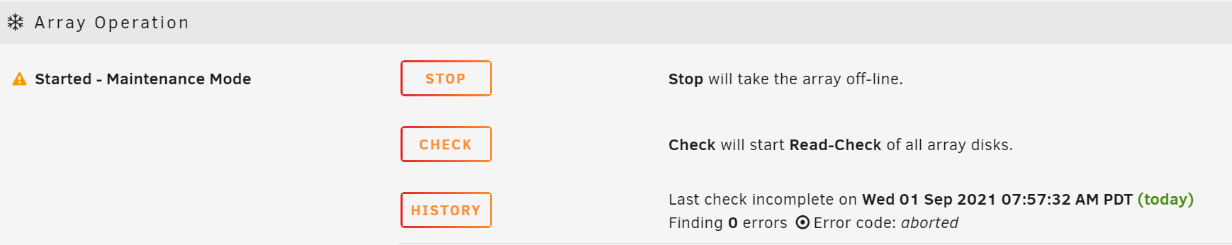

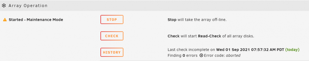

  • The main issue now is that I cannot stop the array (just hangs and does nothing) . Now stuck in 'Maintenance Mode' and not sure what to do next.

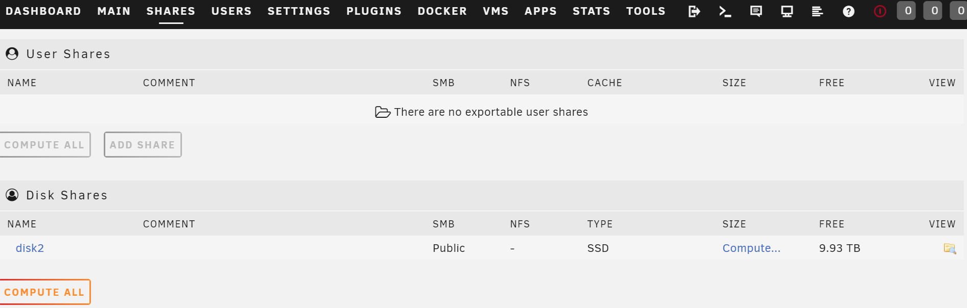

  • Lastly this is also pretty concerning. Not sure if i should be seeing this when i click on 'Shares' while in maint. mode.

To remove a disk from the array, you have to go to Tools - New Config, unassign it, and rebuild parity.
Maintenance mode mounts no disks so there will be no user shares.

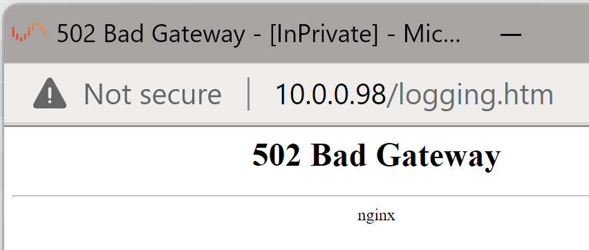

I tried enabling SSH from management access but that is not going either.
Real-time logging appears to be disabled while in Maintenance mode..?

As far as Unraid is concerned, there is still a disk2 in your array, even if the disk has been removed and smashed with a hammer. It is emulating the disk from the parity calculation by reading parity and all other disks.

How did you get that "Erase Device Content"? I assume it was something on the Disk2 settings page shown behind it. Were you trying to change the filesystem? Only wonder because I don't know how you got hung up there.

You haven't shrunk the array until you get a configuration without disk 2 and with parity rebuilt. You have had no parity protection ever since that disk was removed.
I don't think there is much risk to using the power button. No disks are mounted in Maintenance mode. You are going to be rebuilding parity anyway. Go to Settings - Disk Settings and disable autostart. Then when you restart you can go immediately to New Config
