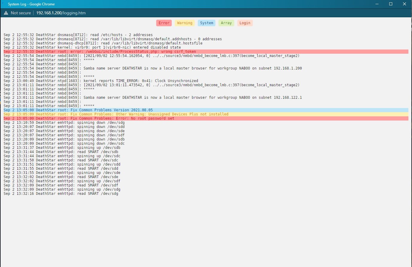

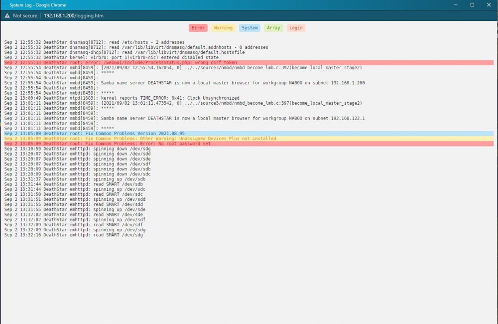

I am not sure about time (12:55) of when I started what? I think this is AFTER I did the hard reset. I am not a tech person so I don't know what "csrf_token" is or why I got error. I think at 13:05 I started updating plugins and such.
would "clock unsynchronized" cause any of my issues?
I am at complete loss why after 3-6 months my Unraid server just "disconnects" even though it is always powered on.
