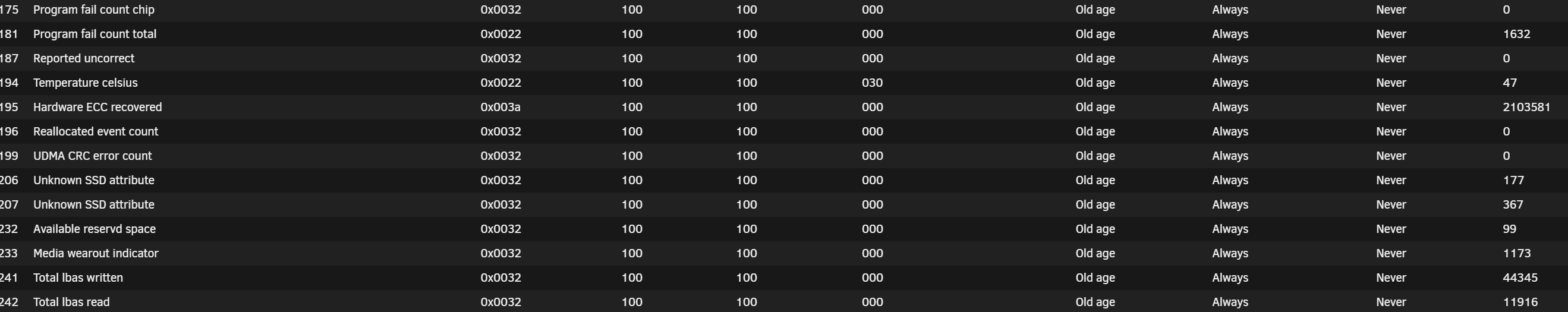

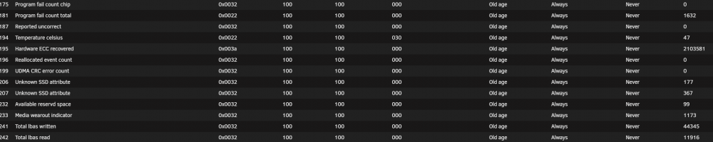

I checked all the connections and made sure they were all ok. Rebooted server and can do a SMART test now. Diagnostics attached. Also screenshot of the disk status and I think this disk is failing.
pcserver-diagnostics-20210907-1823.zip
Not entirely sure how to interpret SMART for SSDs. Run an extended SMART test on the drive.
Have done an extended smart test and no errors found
Post new diagnostics or at least new SMART report for that disk
