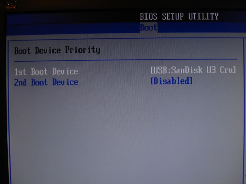

it sounds like the USB drive got kicked from the primary boot device.
Oof!
Checking...
Something odd here:

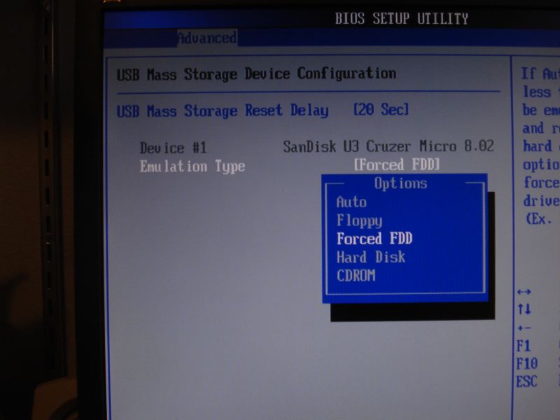

You can see the SanDisk is the only boot device. But it's set to Forced FDD. I think that's wrong.

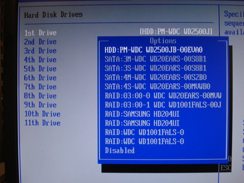

At least the bios is seeing the new disks that I added.
Forced FDD should be ok, it is what I use (using MB slots only)....but
http://lime-technology.com/forum/index.php?topic=9209.msg91639#msg91639
1. Forced FDD or "Auto"?
2. Boot/Hard Disks -> disable all except the flash
3. Boot Device Priority (only the flash)
Edit:  and....I forgot:
http://lime-technology.com/forum/index.php?topic=10769.msg102838#msg102838
Tried Auto for the disk type, but it would not boot. The other two settings were already in place.
The LED on the SanDisk does light up.
Not sure what happened there. I confirmed the SanDisk was in Forced FDD mode, as it was when I first checked the bios. Confirmed the other settings were correct. It booted just fine.
