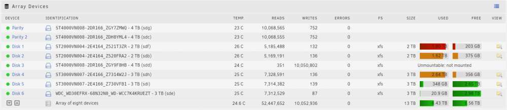

This morning I then installed the new drive in the server and removed the old one. I then started the server, stopped the array and put the newly identified replacement drive in place of the failed drive using the dropdown. I then started the array and it began rebuilding the drive, so I left for work. Now that I returned, I see the rebuild has finished but Disk3 still shows "unmountable: not mounted" with the "Format unmountable drives" option lower down on the page. But on the "# of writes"-counter, you can clearly see that the drive had been written to a lot... (see attachment-image).
I am pretty sure that following through with that format would make me basically lose any data that was on old Disk3, right? What went wrong here? Was it user error? If so, what did I do wrong? Can I fix it now? (old Disk3 still exists, and I think I should be able to pull the data from it if necessary, so not a huge loss...but still...what went wrong here?)
right
Haven't looked at diagnostics yet but since you rebooted we won't be able to see what happened before. Possibly disabled and emulated disk3 was already unmountable before the rebuild attempt, so an unmountable disk is the result of the rebuild.
How did you decide the original disk was bad? Connection or cable on SATA or power (or splitter) are much more common reasons for a disk to be disabled than an actual bad disk.
Do you still have the original disk3?
You will have to try to repair the filesystem, and if the original is still readable maybe it can be used to recover anything filesystem repair doesn't.
https://wiki.unraid.net/Manual/Storage_Management#Drive_shows_as_unmountable
Can you put the original disk3 back in the server as an Unassigned Device? I haven't examined SMART for your other disks, do any of them show SMART warnings on the Dashboard page?
A quick look at Diagnostics and I didn't see anything else of concern.
