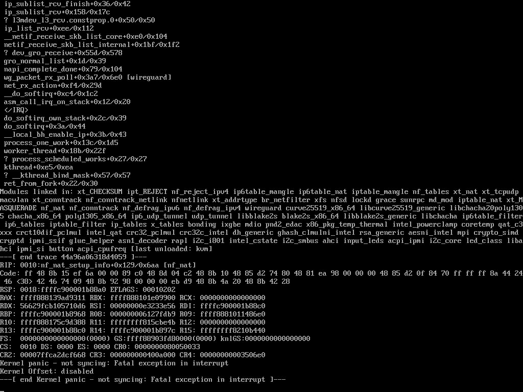

dos anyone have any idea why i got this, it isn't the first time the server is crashed with a kernel panic
my server:
os: 6.9.2
mb: Supermicro A2SDi-8C-HLN4F Version 1.00
ram: 64 GiB DDR4 Single-bit ECC
and a few containers

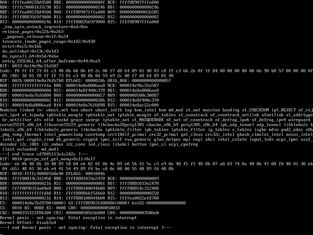

Hi again,
it just happened again, this time without docker running
/DKR

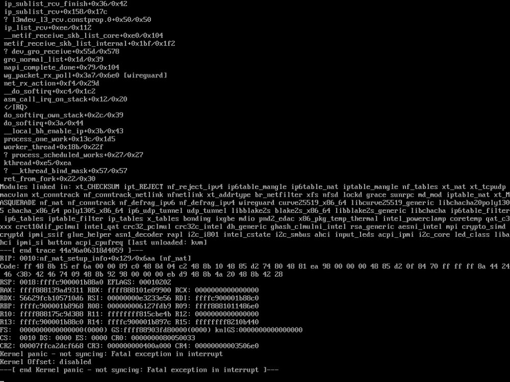

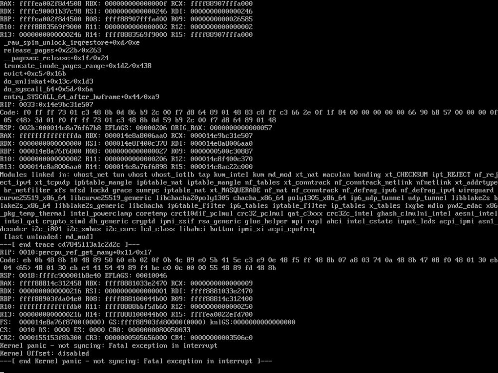

i got this from syslog
how can i get dianostic when the server is crashed?
[code removed]

Please post the complete syslog, you can get the diags after rebooting, in this case it's mostly to see the hardware in use.
I used my second server as a syslog server and copied the whole log.
should i just use the normal tool ->  diagnostics?
/DKR
Those call traces are usually the result of having dockers with a custom IP address, upgrading to v6.10 and switching to ipvlan might fix it (Settings -> Docker Settings -> Docker custom network type -> ipvlan (advanced view must be enable, top right)), or see below for more info.
https://forums.unraid.net/topic/70529-650-call-traces-when-assigning-ip-address-to-docker-containers/
See also here:
https://forums.unraid.net/bug-reports/stable-releases/690691-kernel-panic-due-to-netfilter-nf_nat_setup_info-docker-static-ip-macvlan-r1356/
