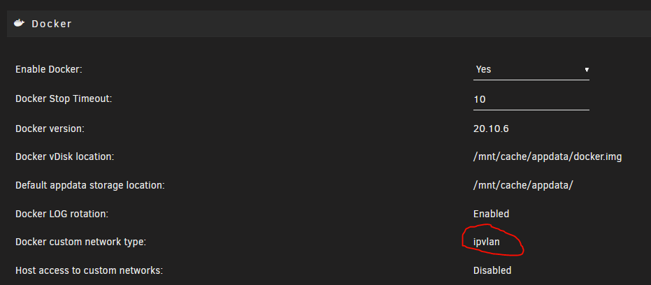

  1. In unRAID 6.10.0 RC1 + you can try setting the Docker custom network type to ipvlan instead of macvlanimage.png.c19ff930ae3299fa504eaaf64f12ab23.png

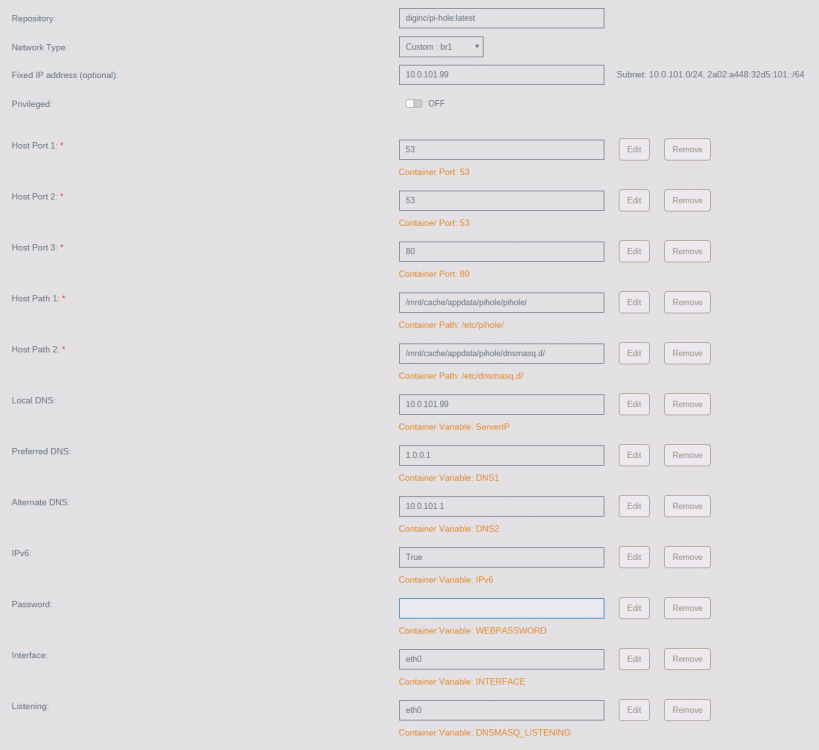

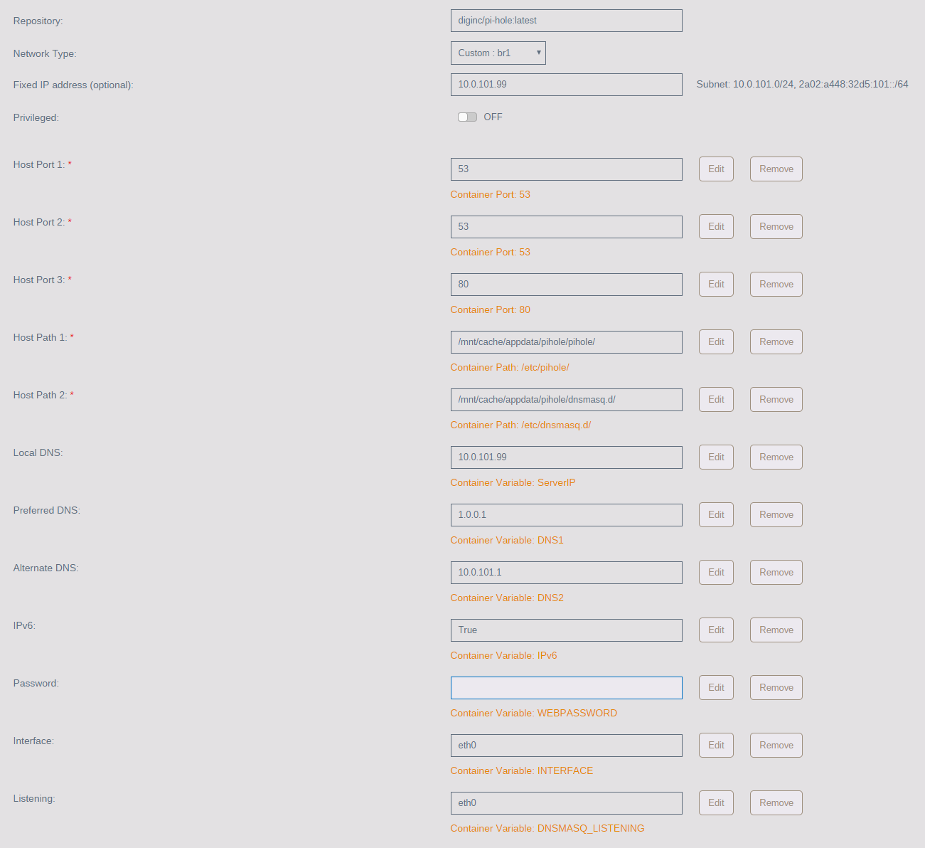

It seems most (all?) of your call traces come from pi-hole. Let's start with comparing the settings of pi-hole and see if there are noticeable differences.

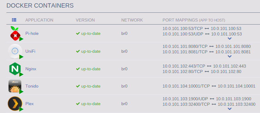

I am running pi-hole on a separate interface (br1) and have given it a fixed IP address (10.0.101.99). This IP address is used both as management and DNS address.
My router is the DHCP server, and it has a configuration to tell that clients in my network must use 10.0.101.99 as DNS server.

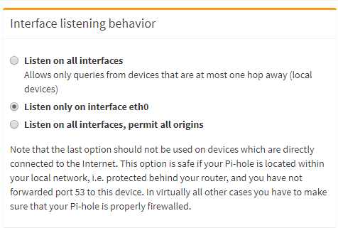

Since pi-hole internally only knows interface "eth0", it is told to use and listen only to that interface.
pi-hole information is stored on my cache pool (/mnt/cache/appdata/pihole)

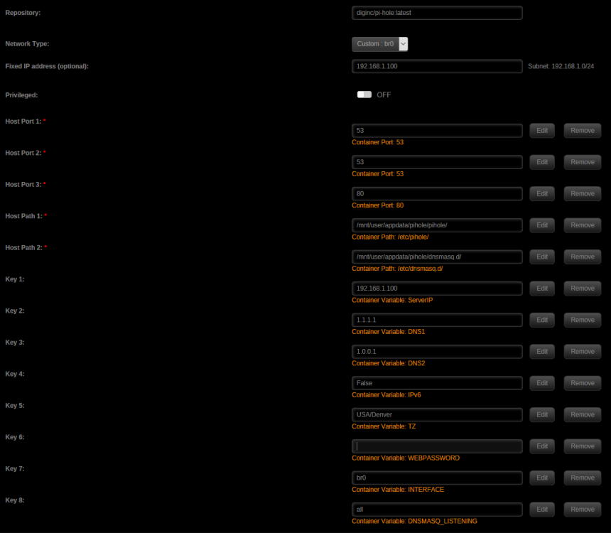

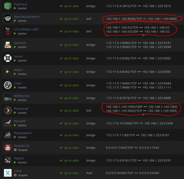

I am getting call traces only from Pihole because it is the only docker to which I currently have a separate IP address assigned.  I got the same call traces when I assigned an IP address to UniFi and OpenVPN-AS.  I have since removed the IP address assignments on those dockers and only Pihole has its own IP address:

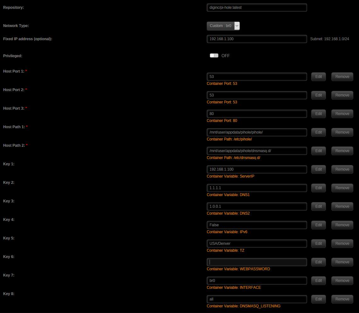

I am using the br0 network and have assigned IP address 192.168.1.100 to Pihole which is both the admin and DNS address.  My router (Ubiquiti USG) is the DHCP server and it is configured to tell LAN clients that Pihole is the DNS.
Here is my Pihole config:
The differences I see are the specified interface which is br0 (not eth0; although they physically share the same NIC) and Pihole is listening on all interfaces.  Should I change those both to eth0?  I followed the Spaceinvader One video guide for setting up Pihole on unRAID (as I suspect many have) and I do not believe changing those variables was mentioned; however, perhaps it is necessary?
Again, some tweaks here may result in the elimination of Pihole generated macvlan call traces, but, I did experience them with other dockers as well.  Admittedly, that was with unRAID 6.4.0/1 and perhaps they would be less prevalent in 6.5.0/1.
Thanks for your assistance.
I see the macvlan call traces seem to be associated with a macvlan broadcast.  macvlan_process_broadcast seems to come just before each call trace and the broadcast is referenced in the trace. Is this because the docker INTERFACE variable is br0 instead of eth0 and it is listening on all interfaces instead of being restricted to eth0?
UPDATE: I have gone ahead and changed INTERFACE and DNSMASQ_LISTENING variables from br0 to eth0.  We'll see if that changes anything.
Edited by Hoopster
@bonienl I changed the configuration of my Pihole docker to match yours by setting the INTERFACE and DNSMASQ_LISTENING variables from br0 to eth0.  The server ran for 4 1/2 days with no call trace.  Yesterday, I updated the server to unRAID 6.5.1 final.  It ran an additional 24 hours until another call trace appeared.
I'll try next what ken-ji suggested and move pihole docker to br1.  I have enabled eth1 and cabled that to my switch without assigning a static IP address to eth1.

@bonienl
In my case, I think I have isolated the problem to br0.  If I have even one docker with an IP address on br0, I will get call traces.  As an experiment, I setup a docker VLAN (br0.3) and assigned a couple of dockers to the 192.168.3.x subnet while removing everything from br0.  It has been almost 12 days now with zero call traces.  I thought that might have to do with dockers generating little network traffic, so, I restarted my Pihole docker and assigned it to br0.3 as well.  So far, it is two days in with zero call traces on br0.3 (needs a bit more time to be sure).
When I had dockers (any docker) assigned to br0, the longest the system went without a call trace was four days.  After running for a few more days with all dockers on br0.3, I will move one or two back to br0 as a final test.  If I get call traces on that interface within a few days, that will solidify my conclusion that br0 is the source of call traces on my system.
I think the other users (at least a half dozen or so) reporting call traces with docker IPs also had them on br0.
I would prefer to have dockers on br0 and the same subnet as the rest of my LAN, but, if that is not possible, br0.3 appears to work without generating call traces even though it isolates those dockers completely from the host unRAID system.
Macvlan call traces are definitely caused by assigning IP addresses to dockers on br0 on my system.  With several dockers assigned IP addresses on br0.3 (docker VLAN), unRAID ran for over two weeks without a single call trace.  Within two days of assigning a couple back to br0 as a control test, call traces again appeared.
I think it is safe to say, I only get call traces with dockers (any docker) assigned IP addresses on br0.
