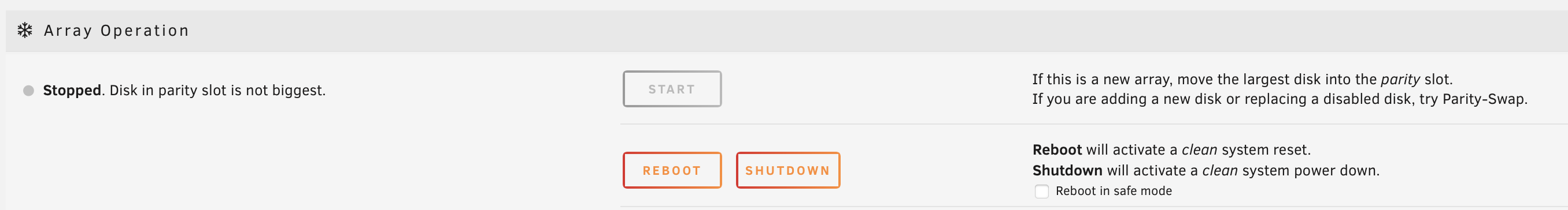

Hi All,
I seem to be unable to add a new drive to my array, even though they are all the same size.
The drives are all 2TB, and everywhere I look they are reported as exactly the same size.
What I've tried (which didn't work!)

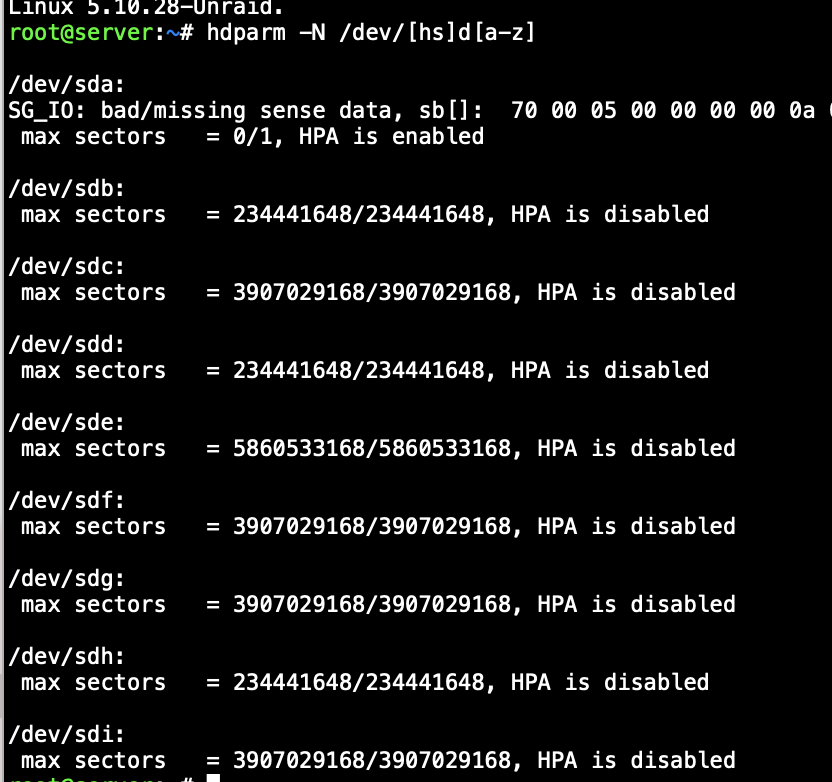

- Checking the "HPA" status - disabled on all drives

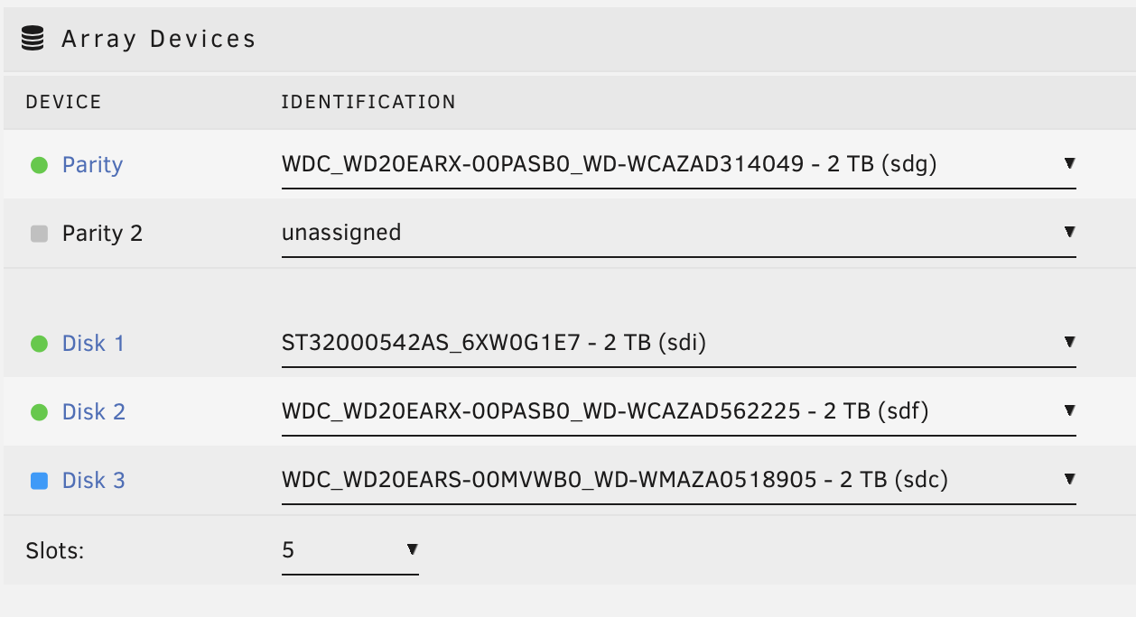

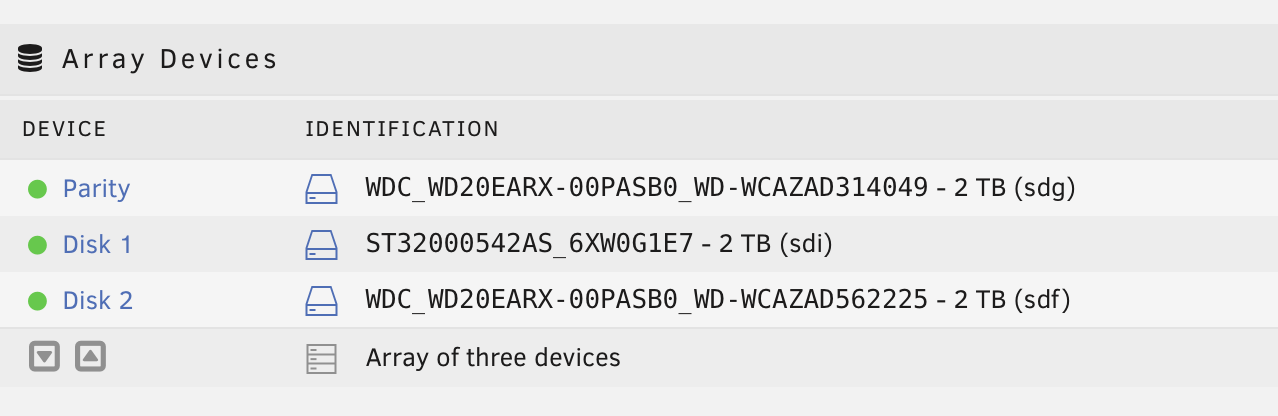

I've attached some screenshots and the system diagnostics - anyone got any ideas?
Array of 3 drives

Array to add Disk 3

Error
