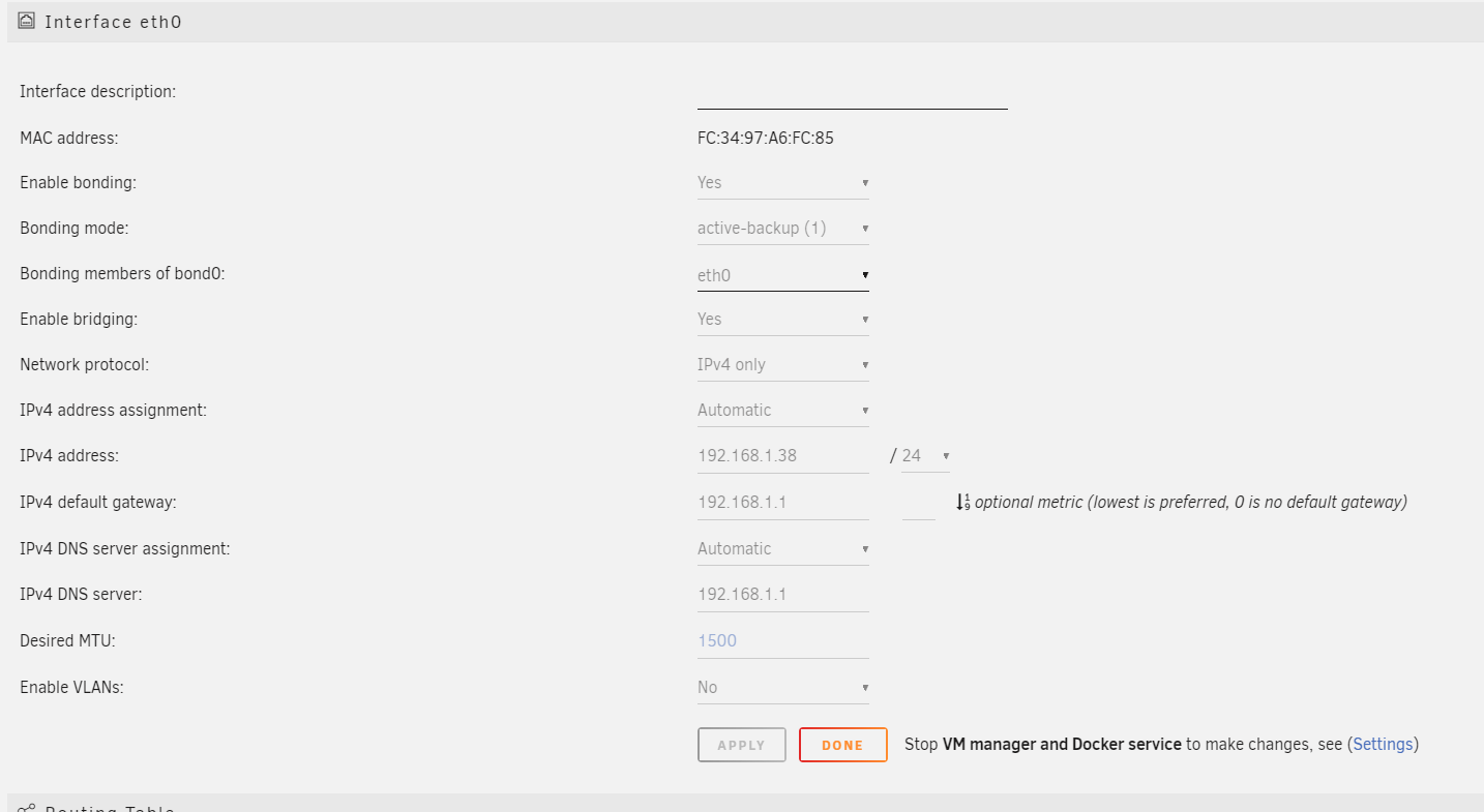

This is my first ever server build.  I initially could not install the license key via the web GUI, but I managed to download and install it directly on the thumb drive from my PC.  Now, when I attempt to install Community Applications, I get the following:
plugin: installing: https://raw.githubusercontent.com/Squidly271/community.applications/master/plugins/community.applications.plg
plugin: downloading https://raw.githubusercontent.com/Squidly271/community.applications/master/plugins/community.applications.plg
plugin: downloading: https://raw.githubusercontent.com/Squidly271/community.applications/master/plugins/community.applications.plg ... failed (Network failure)
plugin: https://raw.githubusercontent.com/Squidly271/community.applications/master/plugins/community.applications.plg download failure (Network failure)
Are these linked?  Is there an issue with my network that would prevent Unraid from accessing the plugin/network license key?  I've attached my diagnostic folder and a screenshot of my network settings.  Don't worry, I'm new enough that calling me an idiot won't hurt my feelings.
silentlibrary-diagnostics-20210929-1540.zip

15 minutes ago, Vr2Io said:
Any blocking at router ?
That's what I suspected, too, but I can't find anything.  I've got a Netgear router, and both the router login and the stupid Nighthawk app show that it's allowed and connected.  Any suggestions where to look, or should I just start resetting everything (router, pc, unraid server, dog, cat, etc)?
20 minutes ago, Vr2Io said:
No reason for dhcp will assign network setting but unreachable.
Apparently it was your words to the Cybergod's ears, because I wanted to try one more time and see what the router logs said happened, and it went right through.
I sincerely thank you for your efforts, and I'll put this down as a possible solution:  Log into your router when you're trying so that it knows you're watching...
