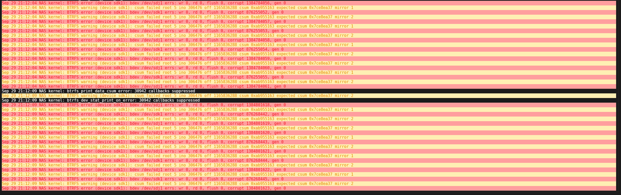

My log is filled with this error and I have no idea what it is. I know sdk1 and sdj1 are my cache drives. Both are 500GB crucial drives, no smart errors and set up in the standard raid 1 pool thing unraid puts cache drives in.
I also have my computer hard crash when playing steam games that are stored on my server. They're on the array saved on one disk, a WD Black. If I move the game to my local drive it works fine and doesn't crash my whole pc.
Anyone got any ideas? I'm completely lost here

btrfs is detecting data corruption, first thing to do is to stop overclocking the RAM, see here for max supported speed for your config, then run memtest and a scrub on the pool.
Ram has been dialed back, turns out I actually had 2 bad sticks after running memtest. I've scrubbed the pool however Im still occasionally getting the error. Not a constant stream of it anymore though.
Syslog will list any uncorrectable files, these need to be deleted, restored from backups.
Dude, thank you so much you're awesome I was basically shitting bricks thinking I corrupted my system files or such you're a chad and a half
