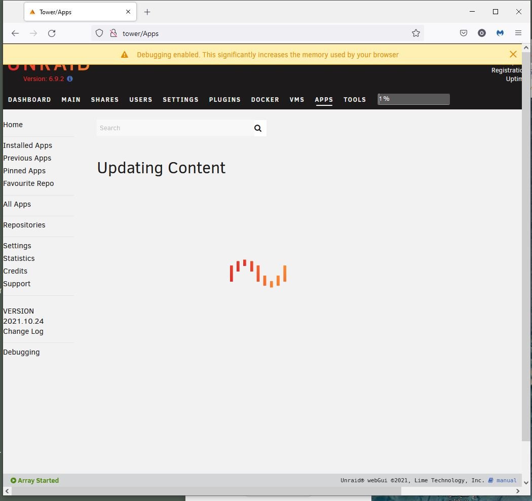

now I am in the mess of the app not loading not sure what to do. There is any command line to stop debugging enable?
Edited by yoyomama
Okay, I had to get in to CA settings   and I got lucky as not let me easy get off the refresh loading
