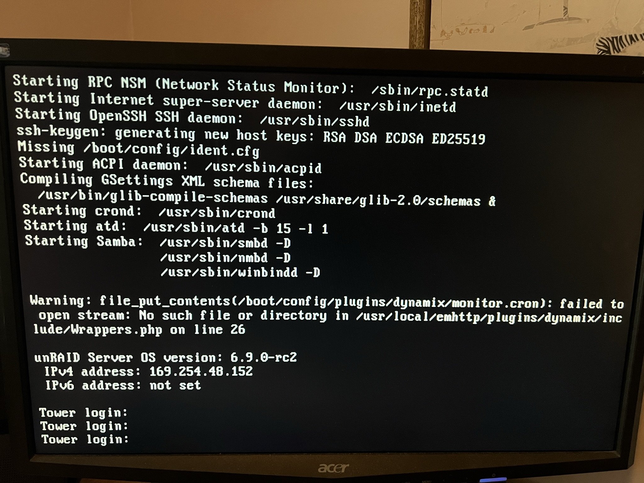

I attached a screen shot.
what should I do now?

As I recall, you will enter   root   to the   'Tower login:'   prompt that is on your screenshot.  Then when the Password prompt comes up just hit the <ENTER> key.
