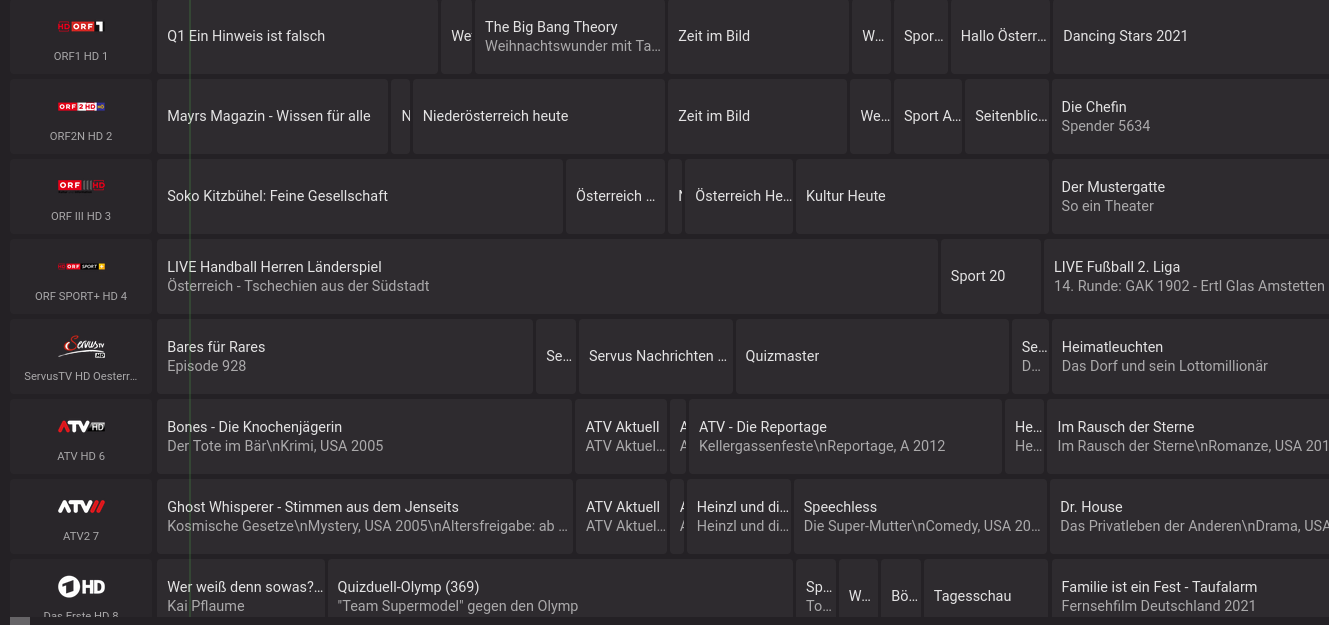

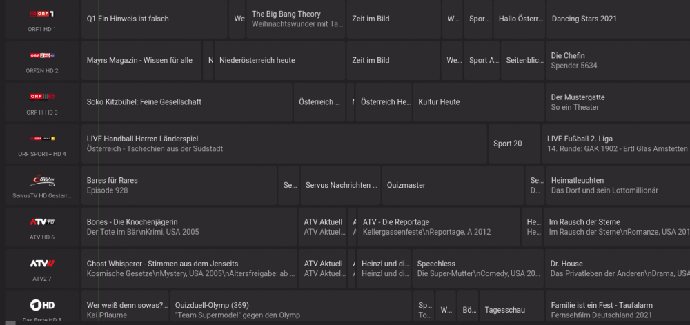

I use it like this with my DigitalDevices and Nvidia Cards:
  • Install Nvidia Driver plugin
  • Install DVB Driver plugin
  • Pass through /dev/dvb in the Docker template from TVHeadend and configure everything to your likings
  • In Emby connect to TVHeadend via XML TV (I don't like the plugin verry much because sometimes it gave me only spinning circle when the connection to TVHeadend was lost only for a short time)
And it works like charm:
