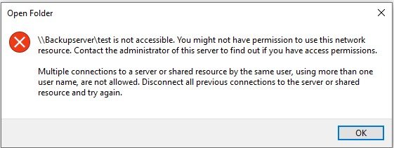

As like one share folder is open of Unraid from my windows pc and again I need another share folder open of deference user from same windows pc but login page show Access denied when login with correct user name and password then show error message. See the attach file of error message.
Please suggest me how to solve this problem

As stated in the error message Windows will not allow you to log into the same server using 2 different sets of user credentials at the same time.
a common workaround is to make one connection using the server’s name, and the other the server’s IP address.   In such a case Windows does not realise they are both connections to the same server.
  • 2 months later...
I have the same problem on my Windows 11, which I freshly installed, however I don't have these shares even visible therefore cannot remove them. I tried this workaround and was able to make 2 out of 10 shares others are failing again with the same error, very random.
