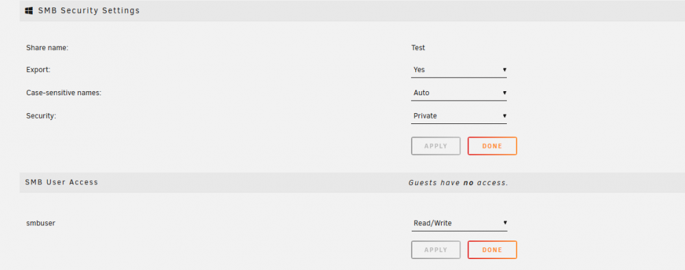

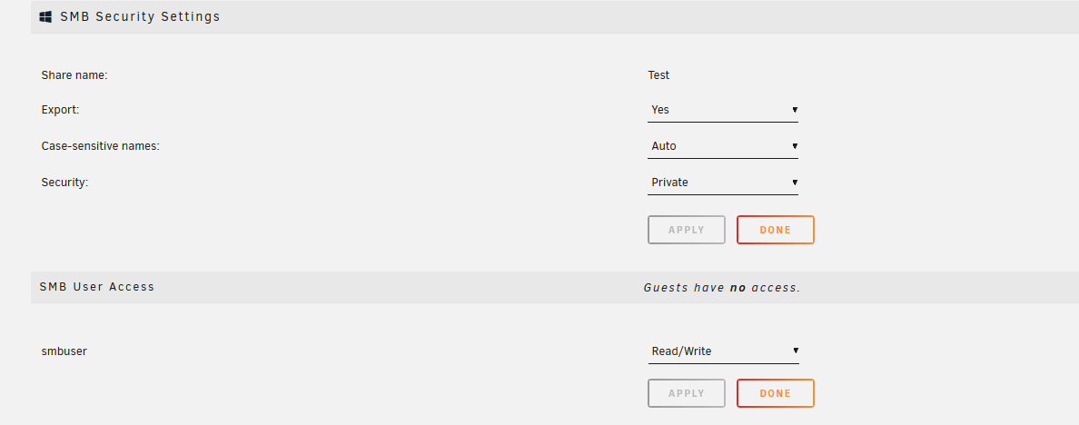

OK, let's start to have a look at your problem.  I set up a share on my Test Bed server as follows:
The share was setup so as no use the cache drive, so the files were written directly to the array.  My login to this server is as smbuser.

 I had no problems deleting a file in this share.

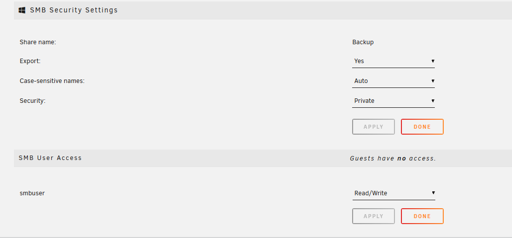

Here are the settings on this Share:
 I had no problem deleting an entire directory/folder using Windows Explorer that was owned by 'nobody'.  (By the way, initially, I had the permission for 'smbuser' set to "read-only" and I got a very similar error massage that I needed permission from 'nobody' to perform the delete operation!)
Double check that you have all of the Share permissions set up correctly and the SMB Users have the right permissions.
