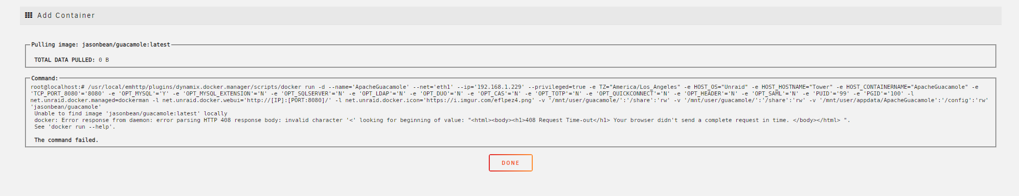

November 8, 20215 yr I played with Docker in the past and did not have this problem. I have not changed anything on my home network. My server is up to date. I've tried to load many different apps and get the same command failure. Ive tried bonding and bridging the NIC's, I get the same problem. I can run Auto Update Applications App, It reports that everything is up to date Unraid Docker.txtUnraid log .txtUnraid network.txt Looking forward to any help.

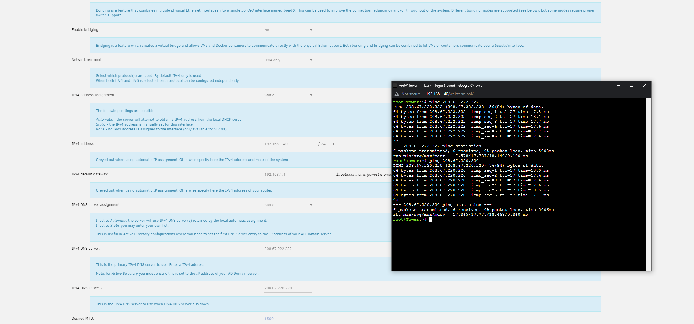

November 8, 20215 yr Any adblockers / extensions that may be interfering? Try setting static DNS addresses in network settings of 208.67.222.222 / 208.67.220.220 And while you're at it, check the date / time on your server
November 8, 20215 yr Author I checked my time and confirmed it was correct. Good call with that didn't even think about that. Question, The only place I can change my DNS is on my eth0. I changed it to 208.67.222.222 / 208.67.220.220 and tried to pull down a app. Had the same outcome.
