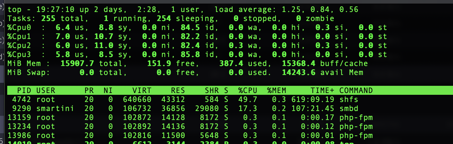

This is the screen of the top during iPhone pictures transfer (hardware is i3-7100 CPU @ 3.90GHz, 16GB RAM and 1gbps LAN)
