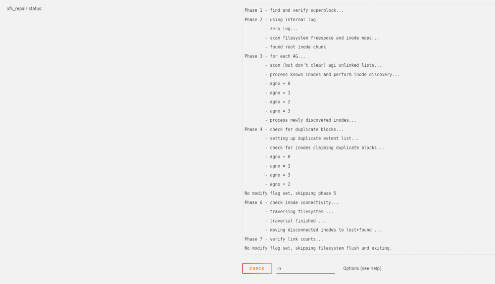

I clicked on the cache drive in the UI and then ran this:
It doesn't tell me what to do now but I also can't mount it. I did try a step with -L in it according to the other topic. Can anyone help me? I would hate to have to reinstall everything on that drive.
If you look at the last line it is telling you that it is going to do nothing unless you remove the -n option and run the xfs_repair again.   No obvious errors are being reported so it is highly likely the repair will fix things without any data loss.
After doing so you should stop the array and restart in normal mode.   I would expect the drive to now mount cleanly and all the data on it be intact.   Having said that you might want to check for a Lost+Found folder as that is where the repair process puts any files for which it could not find directory information - I suspect you will not have this folder.

Thanks. I just did that and the drive has come online.
The drive is back online and all Docker containers start without any problems.
