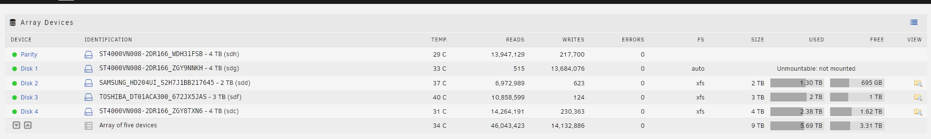

It all seemed to be normal and I backed up all really critical data just incase of a problem. Then I stopped the array, reassigned disk 1 and started the array. I watched the rebuild progress to about 52% but needed to do other things when I came back it seemed to have completed the rebuild but disk1 is still unmountable.

I guess it's moot now since rebuild has already completed. You will have to repair the filesystem.
But first, post new diagnostics. Hopefully you didn't reboot after the rebuild.

So, emulated disk1 was unmountable when you began the rebuild. But, as I said, moot now since rebuild has completed. You have to repair the filesystem on the rebuilt disk.
https://wiki.unraid.net/Manual/Storage_Management#Running_the_Test_using_the_webGui
I am getting a bit confused. I put the system into maintenance mode but when I go to disk1 there is no Check Filesystem Status available.
