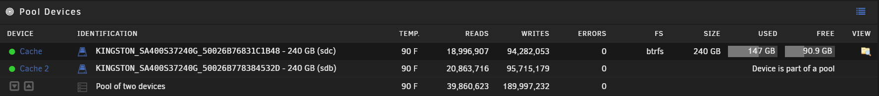

I have two SSD drives, both 240GB. I thought I configured it right so I would have a total of 480GB for cache but as you can see from my screen capture it's showing as only 240GB. Is my understanding of cache pools incorrect, or have I configured something wrong? Any help is appreciated.

So I converted it to RAID-0 under the Balance option and now the majority of my dockers won't start up and I'm getting the error "Unable to write to cacheDrive mounted read-only or completely full." under Fix Common Problems. What did I bork?
Edited by thunderclap
Still post the diagnostics, but did you wait for the balance to complete?  (Last time I did this was on a fresh cache-pool with basically no data on it)
On 7/18/2016 at 4:46 AM, JorgeB said:
When changing pool mode confirm that when the balance is done data is all in the new selected mode, check "btrfs filesystem df"on the cache page, this is how a RAID10 pool should look like:
I just saw these responses after researching. I don't think the balance was done when I switched it to RAID-0, so that probably corrupted the drive. After backing up the cache drive I'm now pre-clearing them and will set them up again. That should do the trick.
