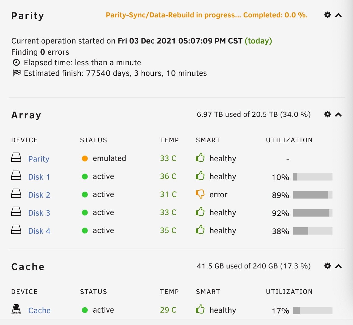

I have a 14TB disk as parity disk, and I started my first checking one day ago. But, I lost the connection to my server (even ping returns timeout) immediately after the checking started, is it normal for not able to access server while first time doing the checking?
And any estimation for how long will it take? My data pool size is 20T and 7T of it is having data, using an old CPU E3-1230v3.
It has been 24 hours after checking began, is it hung or still running?
Thanks for any help.

Before it went down, can see CPU usage are extremely high, about 80% to 100%.

A screenshot before it went down, 77540 days for parity-sync/rebuild, that's 212+ years.....
There are ATA errors in multiple devices, could be a controller issue, use all the onboard SATA ports and then try again ideally with a different controller for the remaining two devices.
I have replaced my SATA control card, it was some ASM1061 chip, I changed it to a LSI 9207-8i card.
Now, the parity sync is running ok, and for a 14T disk, it will take about 30 hours per estimation.
