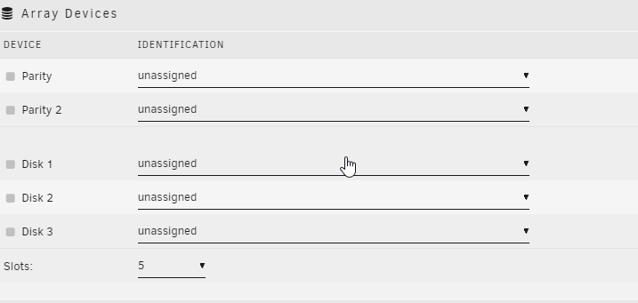

I have an issue with my 3TB  SAS HDDs. Whenever I try to assign them to my Array, the disappear and only come back after restarting the server. Assigning SSDs does not cause the same issue.
Adding the same drives to different pools does not produce this issue, but I can't figure out how to start those pools.
The drives worked without a problem under Windows 10.
I have looked at a ton of other threads of similar issues, but nothing helped so far. Any help is greatly appreciated!
