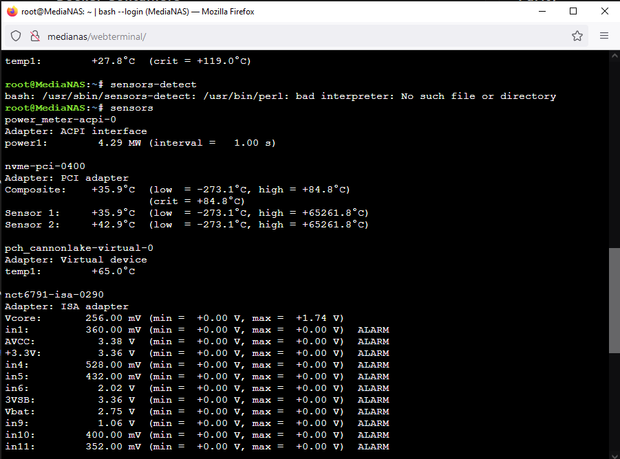

I have a system running Unraid 6.10 RC2, and am trying to execute the "sensors-detect" script in the Unraid shell. When I type "sensors-detect" into the shell, I am left with "bash: sensors-detect: command not found"
I have installed perl with the nerdpack plugin, and can run it successfully on my other system running 6.9. Am I missing something here?

Does typing just "sensors" work?  sensors-detect does not work on my system but sensors does.  For me, it has been this way through 6.8, 6.9 and 6.10 at least.  I don't know what I did that changed that but "sensors" provides plenty of information.

perl is not installed via Nerd Pack

Maybe reboot?  Or make sure that Nerd Pack and the updates are up to date.

Yeah, for some reason everything I had set to install via Nerd Pack (including Perl) had been unloaded.  I had to download them all again.
Alright . I
Verified NerdPack is up to date
Uninstalled perl, rebooted.
Verified that perl is now showing up as Installed:no
Installed perl, rebooted. Perl now shows up as Installed:yes
No go! I still am presented with the error bash: sensors-detect: command not found
Yes - "sensors" does work, but I dont think its doing the job that the sensors-detect plugin does (I'm manually loading some drivers at boot).
