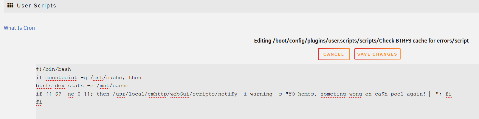

I downloaded the script app you recommended.  Named it, put in a description, copied the script from the above (see attachments).

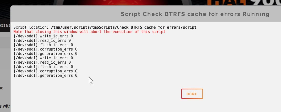

When I click on the "run script" I get the below window with the done button.    This is so cool.  How complicated would it be to have the script not only warn you about the error but then ask you to click Yes to run the scrub with the error box checked, then run a balance, then clear the stats, else click no to abort?  I've never written scripts before and found this very exciting.  Kind of like when I first got an apple II with no drive/cassette and just typed stuff from magazine articles. 🙂
