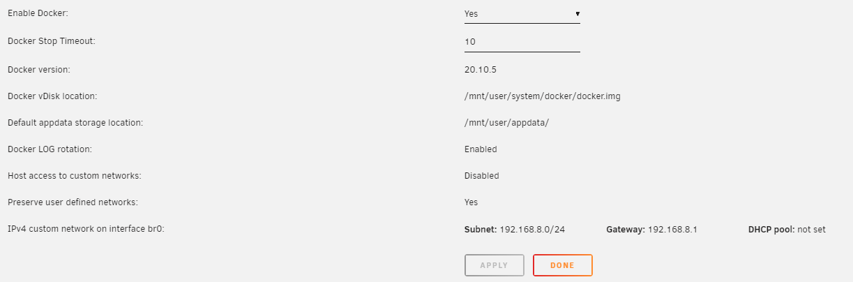

My docker settings:
I have many docker container although the 3 that runs most of the time with br0 are : qbitorrent, plex, tautulli. The rest are either in bridge mode or not running.

Macvlan call traces are usually the result of having dockers with a custom IP address, upgrading to v6.10 and switching to ipvlan might fix it (Settings -> Docker Settings -> Docker custom network type -> ipvlan (advanced view must be enable, top right)), or see below for more info.
https://forums.unraid.net/topic/70529-650-call-traces-when-assigning-ip-address-to-docker-containers/
See also here:
https://forums.unraid.net/bug-reports/stable-releases/690691-kernel-panic-due-to-netfilter-nf_nat_setup_info-docker-static-ip-macvlan-r1356/

Considering that 6.10 is in rc2 I rather changed all my dockers back to br0.
I will upgrade and test with dedicated IP addresses once the prod release will be available.
