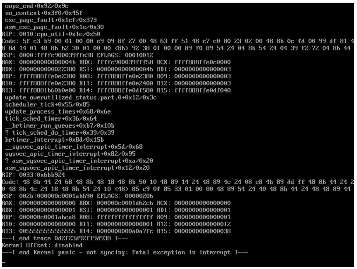

I've been working with UnRAID for some time now, and I recently installed a new MB, CPU and memory. Before I had the occasional crash and never completely figured out why. Now I've got IPMI, I can view the screen and I seem to get a kernel panic. This happened three times now, at random intervals. I've disabled C-states in the bios (and via terminal) and the memory is running on it's design speed (conforming to the best practices tutorial). Temperatures are all within acceptable parameters.
I've added my diagnostics file and the screenshot from the terminal. I am hoping someone can give me some pointers.

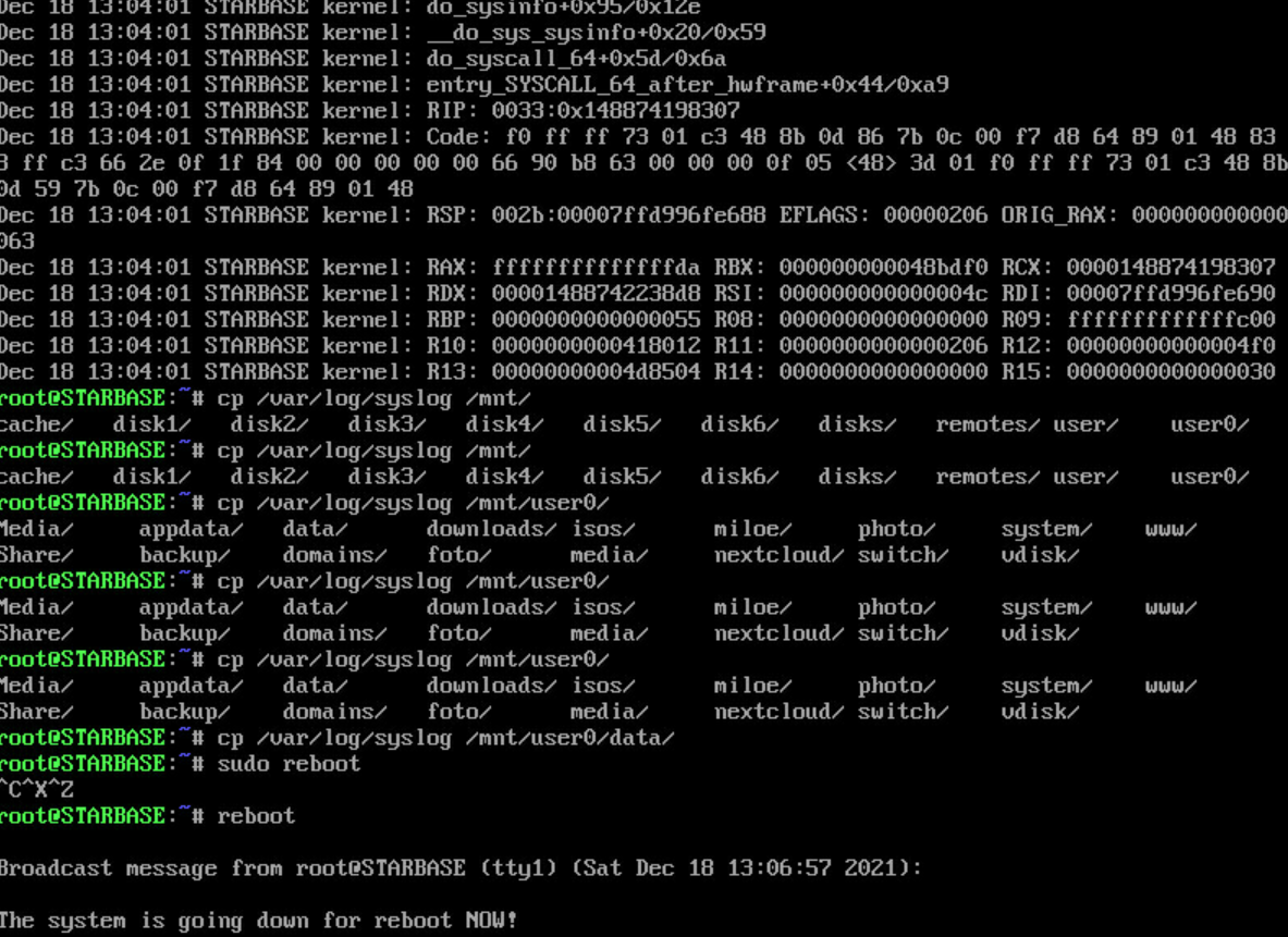

On 12/14/2021 at 6:27 AM, Dieter Koblenz said:
Here's the syslog
Unfortunately no call traces logged there, so not much to see.
I've uploaded a new syslog with several errors, I tried reboot from  the command line but it failed.
Edit: Never mind, I see it doesn't contain anything useful.

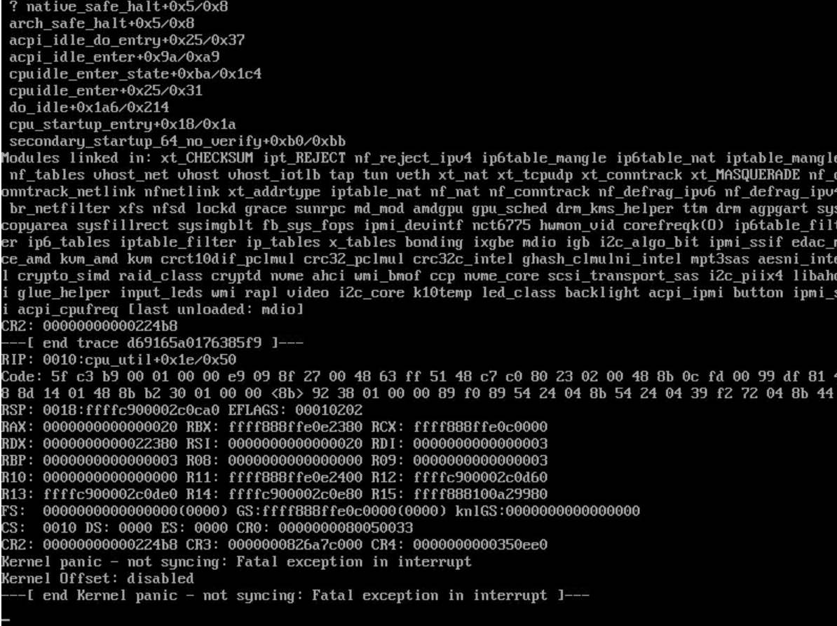

As a temporary solution, I've added a script to reboot my machine at 04 AM. This did prevent crashes for a couple of days, until this morning I had another (new) kernel panic. Unfortunately, I couldn't screenshot the debug screen this time: I did see the following message: rcu_sched stall.
