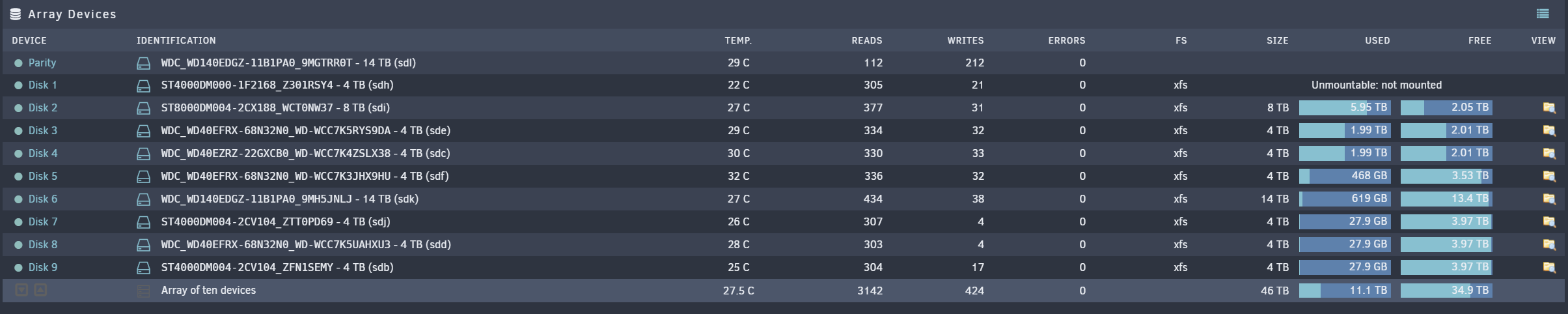

One of my drives failed in the array.   (showed up as unavailable).  I followed these steps to replace the disk:
  • I stopped the array
  • shutdown
  • replaced the faulty drive with a new one
  • booted and went into the array devices and replaced the missing drive with a new one
  • The system rebuilt overnight
Now, it's showing that my new drive is unmountable.  It also appears that the array is healthy?  Not sure what's going on here?

In the slot where the missing disk was (slot 1), it now shows as "Unmountable: not mounted"

The disk in slot 1 is the new drive that appears to have been rebuilt, but shows up as unmountable.
