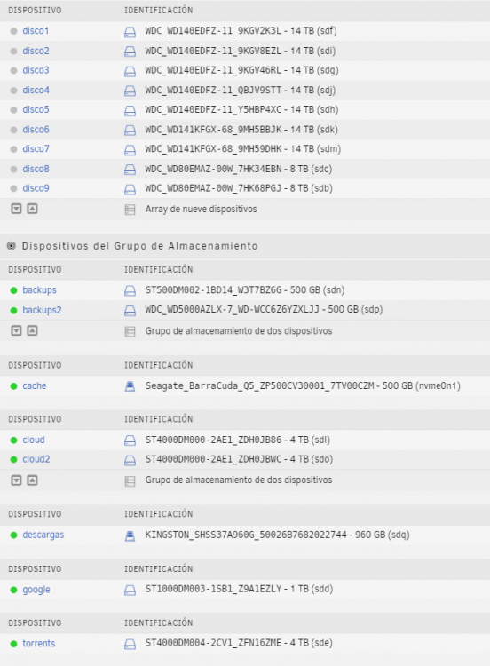

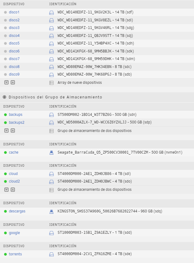

Since I decided to change my SATA PCI card to a HP P822 SAS card, for some reason, spin down function just work for the Array's hard drives, but not for the pools drives as you can see on next screenshot (I know that the interface is in Spanish, but is just to show grey/green lights):
The thing is that all the hard drives are connected to the same SAS card (HP P822), so I can't understand why that difference between Array's hard drives and pools hard drives.
I forced them to spin down but nothing happened.

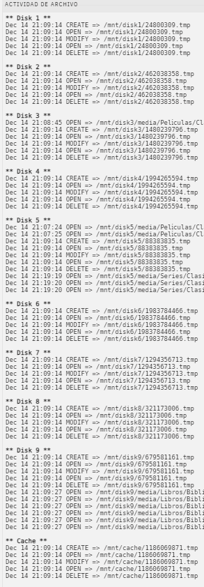

With the FileActivity plugin I can see activity on Array's hard drives, but nothing on pool's hard drives:
With no activity on those disks and without anything waking they up...
