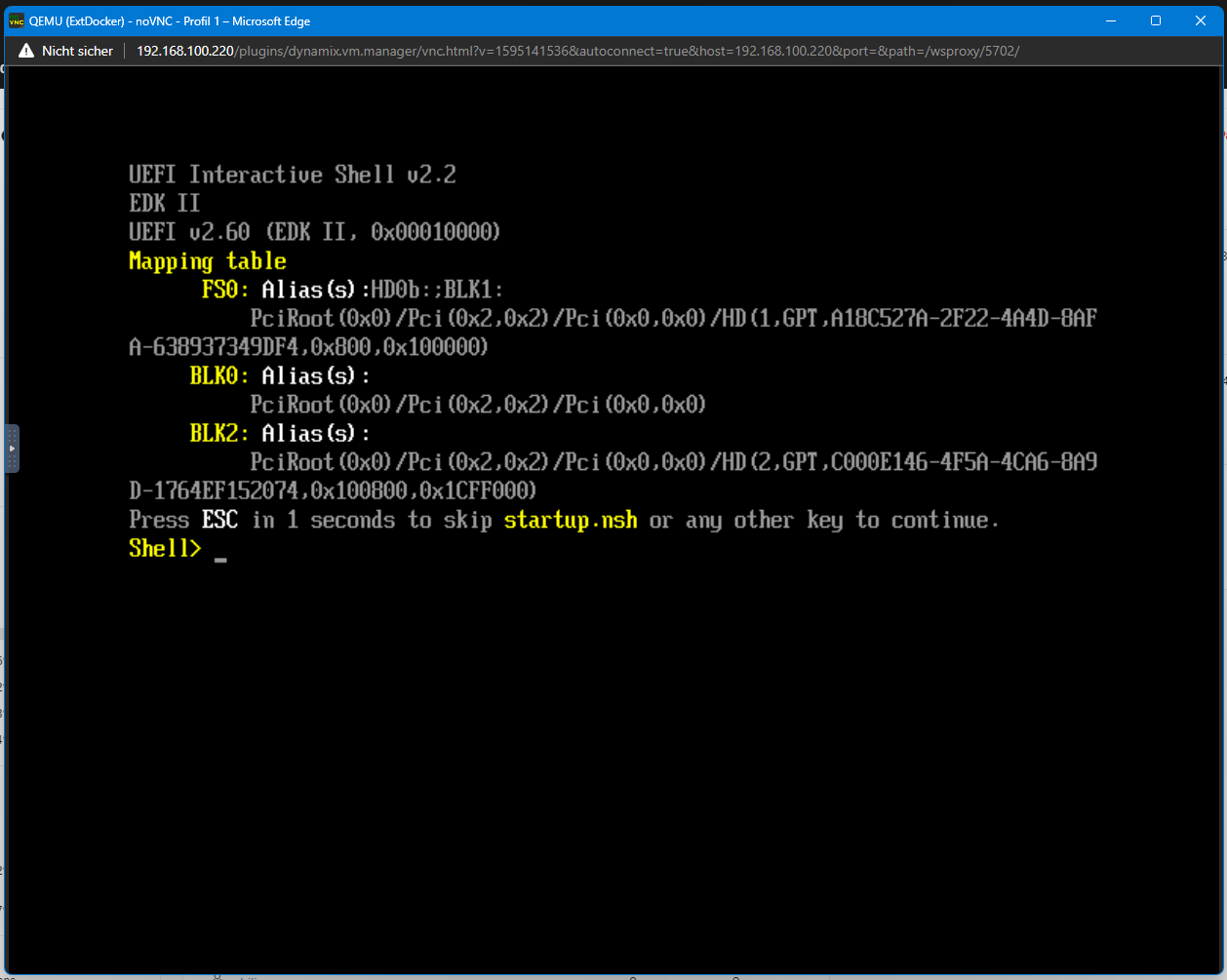

I'm in the process of migrating vdisks to a new SSD drive. I'm using Midnight Commander to copy the vdisks to the new location and then remapping the disk in the VM config.
After this I try to power on the VM boots in the shell. I've tried exit and then selecting different boot device, but with the same result. This happens if I try to change it back to the old vdisk location as well.

guys...without logs/diagnostics it's nearly impossible to reply with consistent advices.
The fact that you boot into a uefi shell, if I read what you posted can be everything...error in configuration, wrong type of disk type, wrong bios (ovmf vs seabios), corrupted vdisk, etc.
Always attach diagnostics because without it and a proper description of the issue nobody will care to reply.

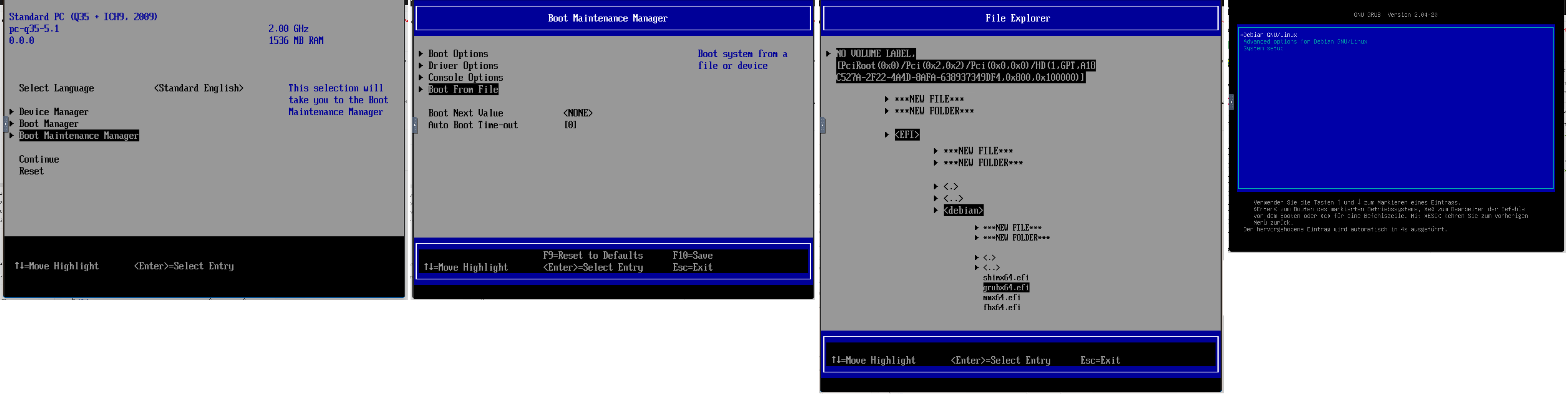

I have attached 2 more pictures.
In the first picture you can see that the vdisk is not booted.
In the second picture I called the menu inside the VM and selected "Boot from File", then the whole thing works.
Unfortunately, I do not know how I can change the whole thing so that the whole thing works automatically.
It happened to me with my linux vm too, I needed to add a boot entry in ovmf to boot from file.
For the second case, are you saving the boot from file option (choosing the boot file and adding a description)?When doing this the entry should be saved in OVMF_VARS and it should be persistent.
Check also the Boot Manager option, as far as I can remember I needed to change also the boot order, after making the new boot entry (boot from file).
Edited by ghost82
Thanks for your help.
Creating a new boot option (boot from file) and saving it brought the desired success.
The boot order had to be changed, that is correct.
I hope this helps @Daryl Williams too.
