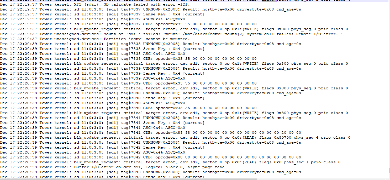

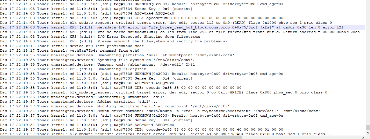

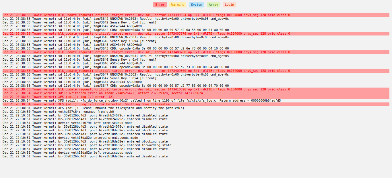

running unraid 6.9.2, recently intalled a new wd purple in hopes of using for cctv footage. it keeps shutting down and showing in historical devices. Ive tried to attach my sys log showing the problem but i keep getting a server error 200 on the forum post here. Hopefully someone can point me in the right direction. Also note i havent recorded or even written to the drive yet. only formatted and mounted/ added to docker to be used

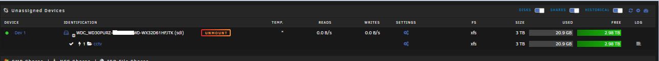

Unplugged sata and replugged. now showing for the time being (i've done this before as well) just didnt last long but i'll keep an eye on it and see what happens. image.thumb.png.a03934f76c4e4be5c1345f934cdd84cb.pngimage.png.5192e2e492b17d0ad08266b236e62d8f.png

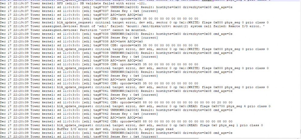

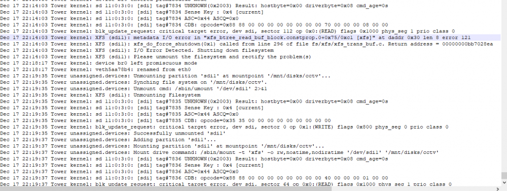

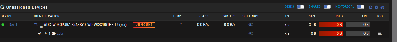

Well the drive lasted for a few days , now back to this. I may end up having to try a different hot swap bay just for heck of it. I'd just like to be able to rule out if it's the drive being bad (it's less than a week old) or if it's something else.

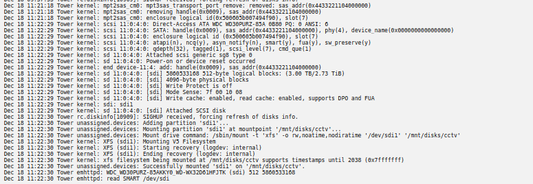

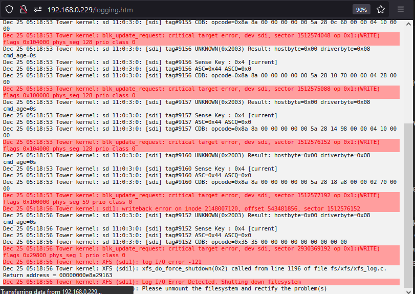

So I've double checked the connections are good and tight. Swapped to a new breakout cable rebooted. Drive comes back but seems to only last a few days before it just "disappears" and errors again, happened to be this morning. This a is  new wd purple not an ssd as you mentioned you've had issues with before. I guess i need to get it back "online" and try to run some smart test maybe?/ Change to a diff hotswap bay? (not sure why that would matter). any other suggestions or ya think the drive could just be bad and run for a few days at a time? May end up trying to send back and see if its really just a faulty drive.

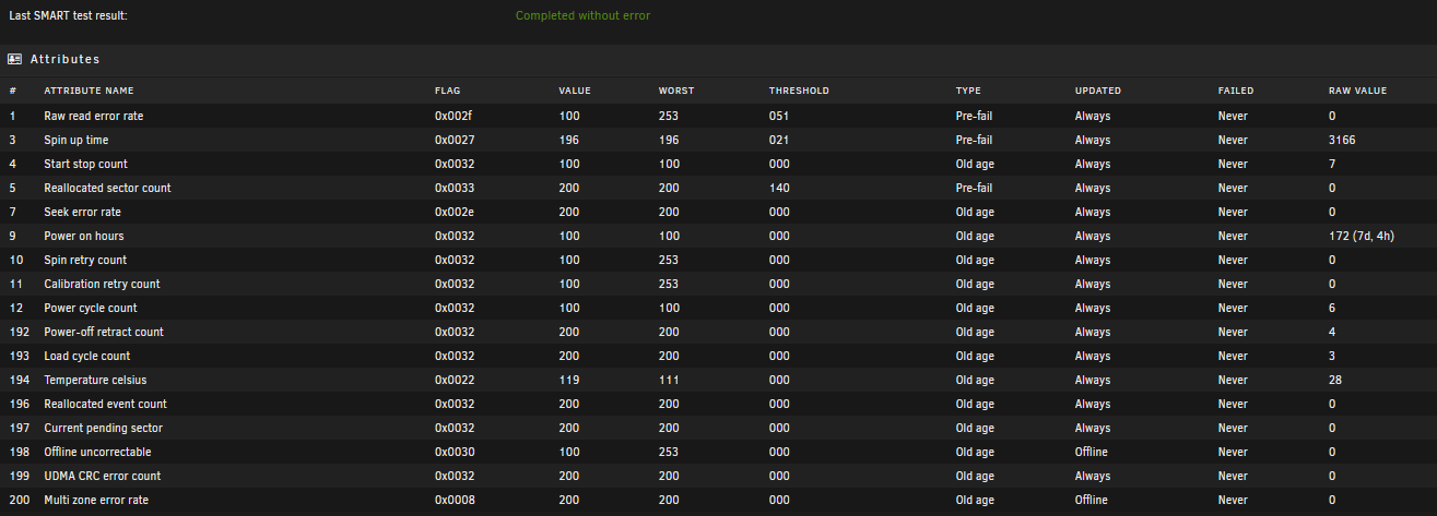

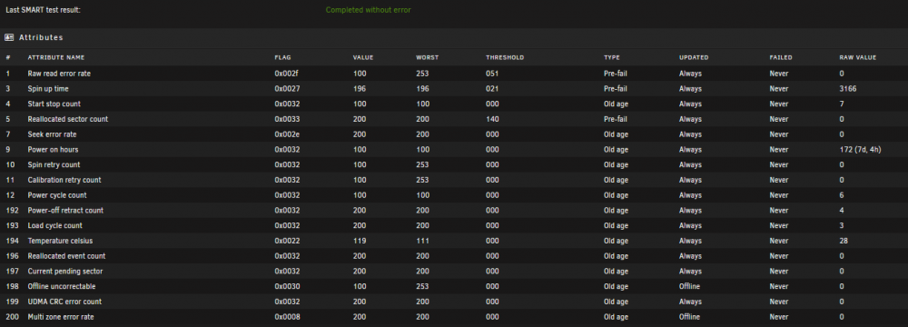

I've also just finished a smart extended self test, came back no errors. not sure if that helps pinpoint anything or not.
