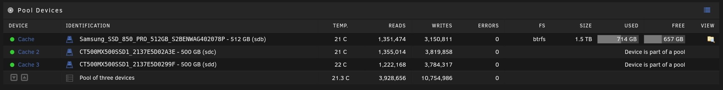

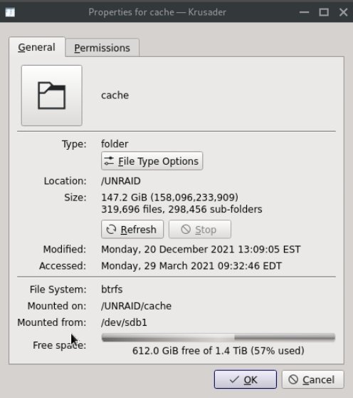

Recently my cache pool filled up and I had to manually move everything over to the array(mover was not moving for some reason). Once I was done, I saw unRAID was showing I still had around 600gb used. I checked all the folders on the cache and could only see about 150gb worth of files. What's going on here? I've attached diagnostics, plus screenshots of my pool and what krusader shows.
Thanks!
swagserver-diagnostics-20211221-2239.zip
Poole has multiple data profiles, you should start by fixing that by balancing to the intended one.

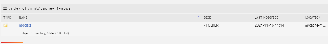

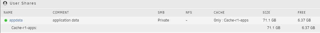

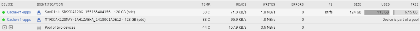

In my case - only 1 share in a pool, says ~6GB free, and only 71GB of data:
I cant find any data on this pool - some ~40GBs are missing.
Krusader:localserver-diagnostics-20211222-1725.zip

At least that the free / used space shown in unraid and krusader can't be correct (71GB vs 113GB) - I've searched every corner in Unraid, I can't explain why this pool should have 113GB in it - it only has 71GB in exactly 1 Folder - same situation as @Swagnoor19 I guess.
Edit: Maybe this helps - There must be some data on it, But I can't find it.
Edited by localh0rst
You only have one data profile, not the same, other than that most tools like du, and possibly Krusader, though I've never used it, might not report the used/free space for btrfs correctly, in your case the GUI will show the correct used/free stats, you cal also confirm with:
btrfs fi usage -T /mnt/cache

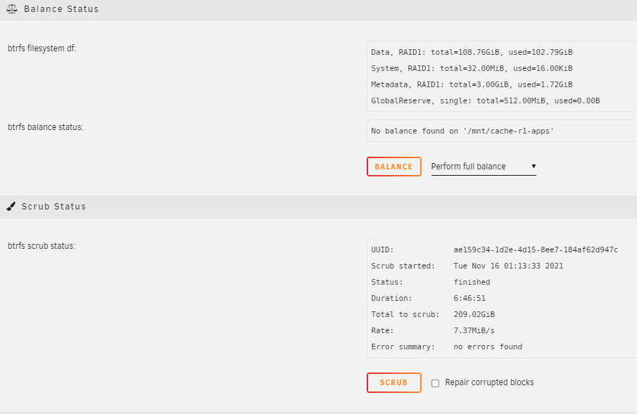

Hi JorgeB, thanks for your reply.
Overall:
    Device size:                 231.03GiB
    Device allocated:            223.58GiB
    Device unallocated:            7.45GiB
    Device missing:                  0.00B
    Used:                        209.07GiB
    Free (estimated):              9.67GiB      (min: 9.67GiB)
    Free (statfs, df):             5.94GiB
    Data ratio:                       2.00
    Metadata ratio:                   2.00
    Global reserve:              512.00MiB      (used: 0.00B)
    Multiple profiles:                  no
             Data      Metadata System
Id Path      RAID1     RAID1    RAID1    Unallocated
 1 /dev/sde1 108.76GiB  3.00GiB 32.00MiB     1.02MiB
 2 /dev/sdd1 108.76GiB  3.00GiB 32.00MiB     7.45GiB
   Total     108.76GiB  3.00GiB 32.00MiB     7.45GiB
   Used      102.81GiB  1.72GiB 16.00KiB
So here it's clear. What I dont understand - the only Share on it is this folder with 71GB in it:
Is there a way I can check where the "missing" 40Gib are located on this btrfs R1? Unraid says 113GB used.
They are not missing, something is using that space, you can move the folders inside somewhere else until you find out the culprit(s).

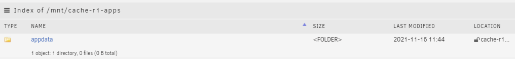

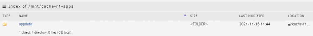

Sure, something is using it. My lack of understanding is, even if I move "everything" - in this case the folder "appdata", it is the only folder in it - can I look elsewhere? some root-folder / mount point where some data is still on the btrfs? Wanted to avoid moving all docker appdata. I appreciate your help.
Edit: This is the only folder in the pool with 71GB
There's nothing else, that folder is using the space reported by btrfs, if there are many small files inside for example it's normal for the GUI to report a different (lower) value.

Hey @JorgeB just catching up here. To follow up on your first comment, if I were to perform a full balance, would that get rid of the data that's still on the cache (I still have appdata and other stuff on there.)
Also I'm assuming that right now the cache is set up as a raid 1, hence why about 500 gb is being used up. Is that correct? If I perform the full balance it would keep it as a raid 1?
Currently it's mostly raid1 but there's some single profile data.
Yes, assuming that's what you want and the profile you choose for the balance.
