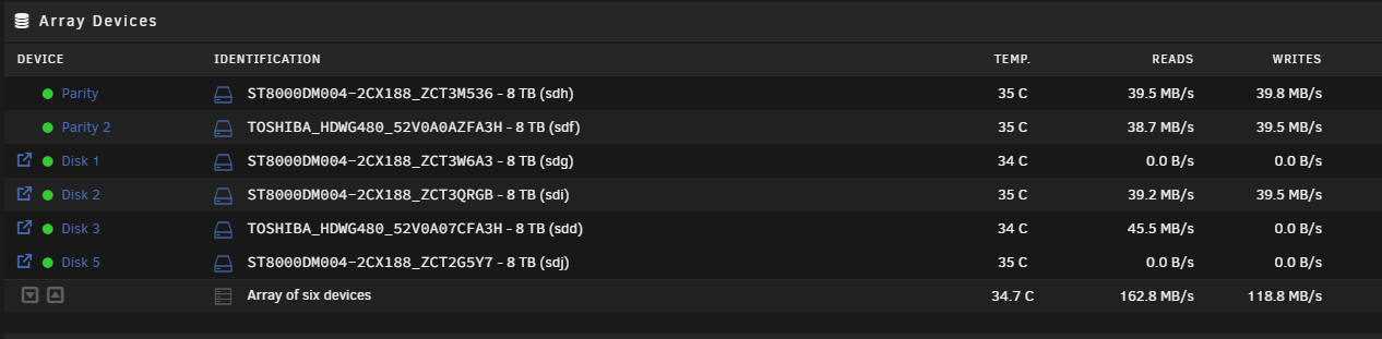

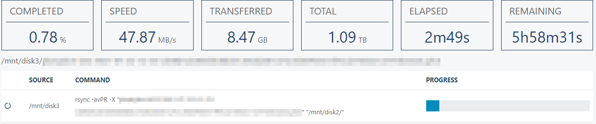

Hi All, I hope my question makes sense, but I can't get my head wrapped around it: I am moving files with unbalance from one drive of the array to another: disk3 -> disk2. So far so good. However, this is the R/W activity of Unraid: To my understanding, the only activity should be: READ from disk 3, WRITE from disk 2 and WRITE on the two parities. Did I miss something? I recently removed a failed disk (disk 4, it was emulated by the parity), made a new Configuration, left the disk 4 empty (I read something about not to touch the order of the drives when double parity is present) and rebuild the parity from scratch, like it is described in the wiki. No parity errors. Now, why is disk 2 having READ access? And should the parity not also have only WRITE activity? Is there still someting emulated? Thanks for you help, localh0rst
