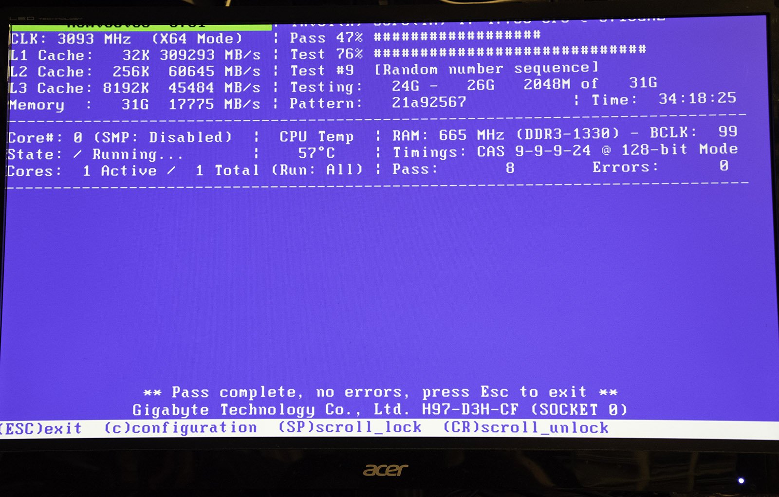

I did run a memtest for over 30 hours and no errors were reported. Refer to attached screen shot. Also enabled the syslog server option and  the syslog saved to one of my Unraid shares.

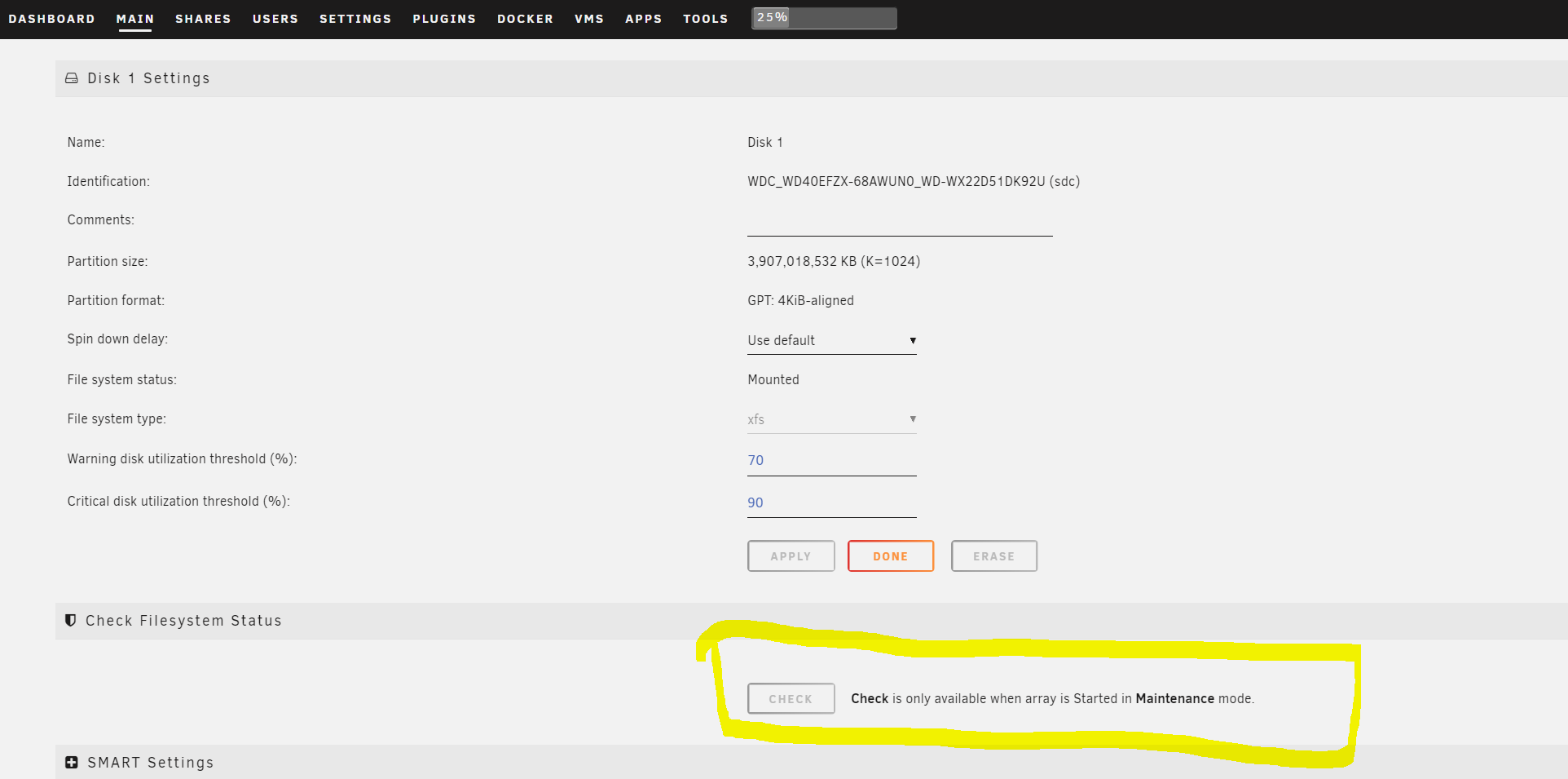

Thanks kindly for the reply. By doing a check disk you mean this option below?

I deleted that comment, as it was actually your unassigned disk that you then began to preclear
