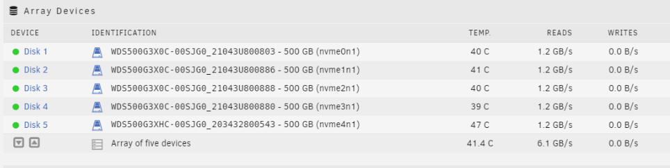

Just so you don't get disappointed don't expect NVMe speeds for array assigned devices, Unraid isn't built for speed, I did a test some time ago and even without parity a read check was much slower than expected, it's not a bandwidth issue since it was done on am Intel Xeon with plenty of lanes, and all devices are using CPU lanes:
Thank you for tempering expectations. I do hate let downs. I'm assuming those are gen 3 NVMe drives. So, roughly 3.4GB/s reads are to be expected. Yikes. Only reading like 35% of expected speeds.
Are you telling me it might actually be beneficial to use one drive as a cache drive even if my cache and array devices have identical read/write speeds? Seems silly. But, okay.
Edited by Jlarimore
Read speeds from a single device might be faster, write speeds to array with parity will likely max out around 1GB/s or less, using it as cache should have better writes versus array.
I guess if all of the input/output channels out of the computer are slower than 1GB/s it doesn't much matter for most use cases. In my case it looks like my wireless transfer rate is fastest (Wifi 6) which I think would be a little over that rate. I guess I will debate whether it would be worth using one drive as a cache disk.
