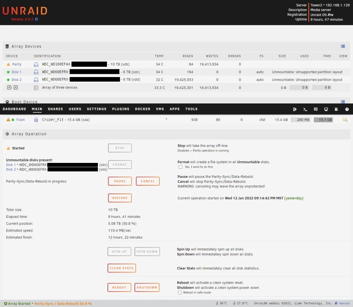

I'm setting up a new system - just pre-cleared (via plugin) my 10TB drive, then installed 2x 6TB drives previously used from the shelf
I configured the 10TB as parity, and the 2x 6TB drives as data, then started parity sync.
I'm wondering why, from the ongoing stats, that reads and writes only appear to involve 2 out of the 3 drives?? (see attached).
Its reading the data disks to get the result of the parity calculation and write it to the parity disk. This is exactly what you should always see on any rebuild, whether data or parity. Lots of reads from all other disks, lots of writes to the rebuilding disk, all zeros in the Errors column.
On 2nd thought, it isn't showing lots of reads for data disk1.
Attach diagnostics to your NEXT post in this thread.
vmstat -d appears to show plenty going on for both sdc and sdd (data drive reads) and sdb (parity drive writes)

so I'm wondering if it's just a GUI/display/presentation issue
It's a GUI issue, if you alternate to speed mode does it show correctly?
Yeah speed mode looks appropriate:
it's just the read/write totals/count display that's inconsistent (dare I say wrong?)
thanks
Could be a device or GUI issue, but those values are known to be inaccurate anyway, even when using identical devices, I would just ignore, keep in speed mode, much more useful.
ok then, will ignore (no other signs of disk/device errors/issues - and the vmstat and /proc/diskstats info seems appropriate for BOTH data drives, despite the GUI)
