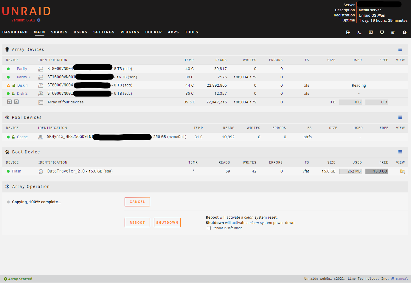

I performed a Parity Swap operation following the steps in the manual. I removed a 6TB drive and replaced it with a 16TB parity drive. Clicked the copy button and waited for the operation to complete.

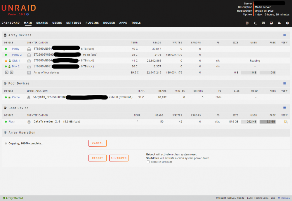

After 24 hours, the webUI reports copying 100% complete. But instead of seeing a button to now Start the array, the copy button remains. The interface says the array is started in the bottom left and the 8tb drive is being emulated. An important note, I never was prompted to enter the array passphrase at any point of this operation.
I was expecting to click Start so the 8tb Data Drive could be repopulated per the instructions-per the manual.

Unresolved, reproduced bug three more times.
There was a kernel crash in the middle of the copy operation, but according to the syslog it completed, not sure if the crash is related or not, try refreshing the GUI, if the rebuild option still doesn't appear I would reboot and start over.

How is this operation performed now? It seems like the steps are in a very specific order to introduce a new drive to the array and perform the Parity Swap. Now that the unraid has seen the new drive and one of the drives has been removed. I don't want to risk a data loss.
3 minutes ago, patric110 said:
Which happened after the copy completed.
No, it happened before:
Jan 22 11:34:40 Tower emhttpd: copy: disk1 to disk29 running
Jan 22 22:09:12 Tower kernel: kernel BUG at fs/buffer.c:3351!
Jan 23 10:23:58 Tower emhttpd: copy: disk1 to disk29 completed
If you reboot you'll just need to start over with the copy, and see if there's no crash this time.
