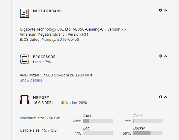

Hi all, still trialling the software, hopefully that isn't this limitation. I have 4 HDDs attached currently, 1 parity, 3 data. I'm trying to remove a 1TB data and add a 14TB drive (WD140EDFZ). I've been using this drive in an external enclosure for a couple of years. When I power on the server, it won't boot beyond the mobo splash screen. Keyboard incidently won't work at this point so can't enter BIOS. Thought it may be a power delivery issue but have tried with just this one drive attached and it won't boot. I've tried formatting the drive with both xfs and ntfs on a single partition and is usable from both my windows pc and a separate linux server I have.
Any help greatly appreciated
Attached diagnostics and specs
