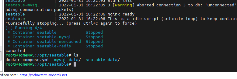

Hello, I am using docker compose to setup seatable on my unraid.
according to seatable documentation, i am installing the dockers files inside " /opt/seatable". so basically , its dependent containers are installed inside the same folder as shown below.
May i ask if above installation is done on array? meaning if one of my harddisk is damaged, will my seatable files be affected?
Any thing that's not ultimately within /mnt/user is lost on a reboot.  You would want to modify the yaml file you're using so that you can map a folder outside of the image (ideally) to somewhere within /mnt/user/appdata
I see. I have not reboot my server yet, that is why it is working well. 😀
I will take a look at on how to map the folders to /mnt/user/appdata
